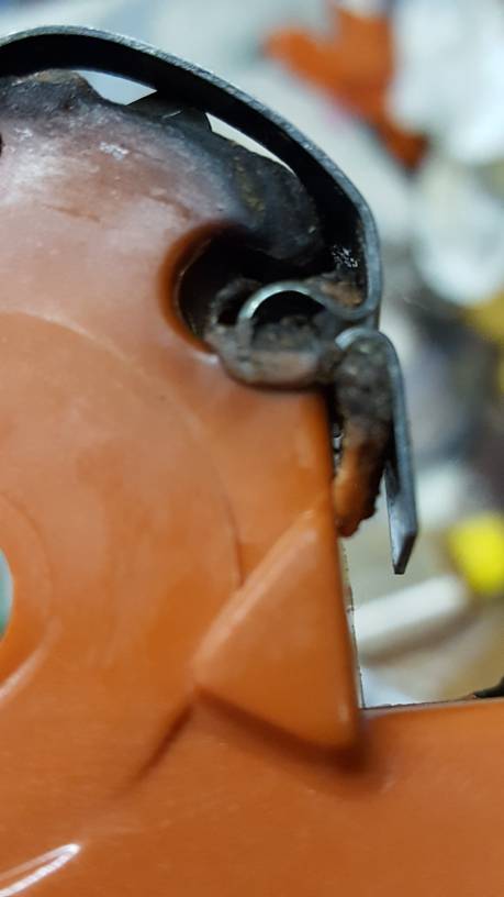

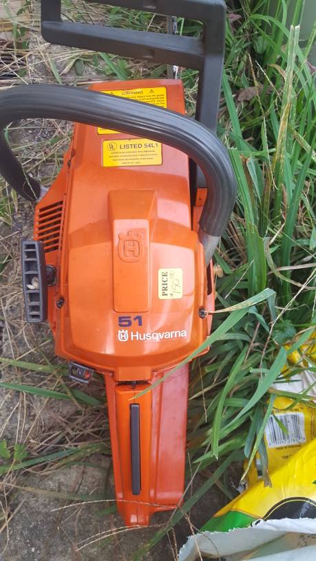

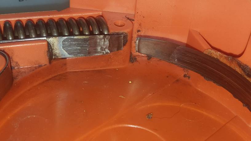

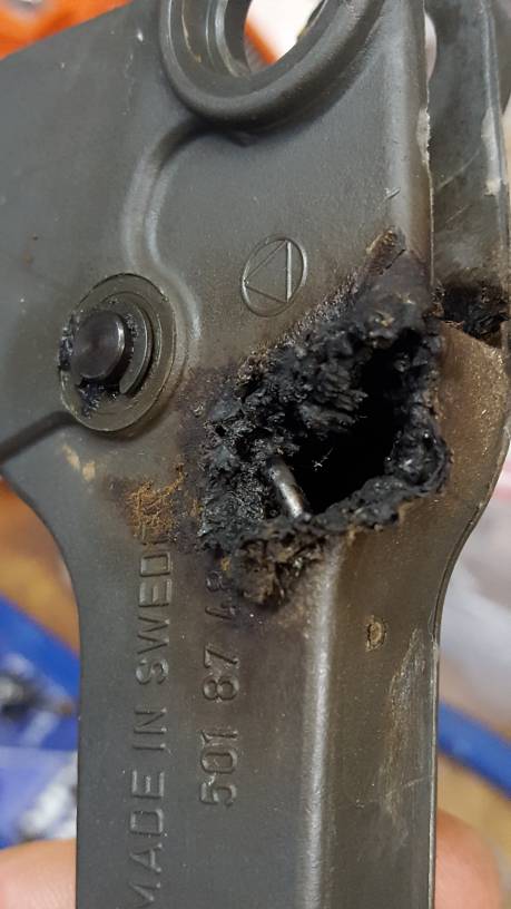

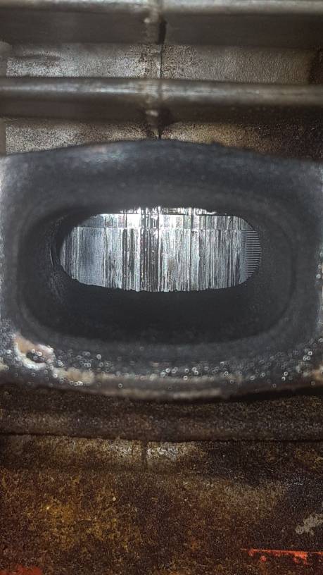

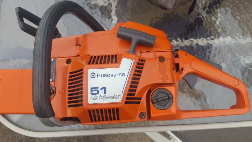

Hey Joe great threads you have going! The timing is perfect! I stopped and checked out a clean 51 at a buddy's shop. When I fired it up it sounded like something was scraping on the clutch. I shut it down and tried to activate the chain brake and it sounded like something snapped. I told the guy running the store that day to tell Tom I was here and broke the saw! Lol! A couple days later Tom calls and says come get this saw and fix it for me.

Dang Dan, looks like it was ran with a loose muffler. Chain brake assembly is part number 503 49 81-03 lists for $74.99 as of 11/24/2017

Muffler was tight Joe! Got me to thinking where all that heat came from though!
