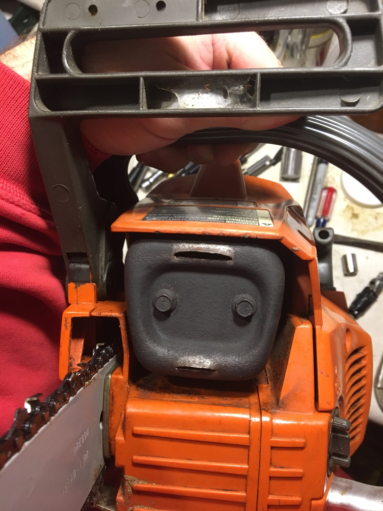

Anyone in here have any experience with a Husky 36?
Picture for reference:
th
My Step-F.I.L. has an old one with a new bar/chain 16" x ? (the bar wasn't marked with what gauge or pitch it is) that will run on a prime but won't stay running and offered it to me along with 3 welded steel (heavy duty) 1/2 cord racks in exchange for about a cord of wood. That's worth $200 to me delivered in town, FWIW. I'll likely do it anyway as he could use the wood and the saw is very light and nimble feeling. I'm just curious with a 14" bar of 3/8"LP (what I want to run) how well it could pull it, provided I get it running correctly. I also wonder if a ported one might give a MS241 a run for its money in the limbing dept and/or if porting would be worth the $$$ on an essentially free saw?

It's an open port clamshell saw. You could widen the exhaust and intake a bit, but can't easily drop the jug for more compression. I had a 41 that I cut some gills in the muffler with a cut off wheel and it actually got about 10% faster. Sty57 has it now

That answers a few questions. I will likely pick it up and see if I can't get it running correctly first, then try to give it a breathing treatment and find the appropriate bar/chain and drive sprocket for it... It could always be a dink around saw for misc odds and ends.

I had Randy port my Husky 36 and it helped it a lot. I'm not sure if I would do it again but the saw had sentimental value so this just made it more likely to get used. I would say it can easily take in a stock Stihl ms250 and may be close to the stock Husky 350 I had. Of course that is running a 16" bar and lo pro chain. Going to non safety chain is the biggest gain for a stock saw, but after porting it is quite respectable.

The 36 is a good little saw, it is the same as a 41, a muffler mod realy wakes them up. my 36 came scored and I installed 41 jug and slug. I have had one 36 and two 41's all had 3/8 low pro 16". They would do graet with a 14". They are A041 poulan mount. you can mod a ko95 to fit. the watch out on these is the intake tube and pulse gromet.

I like the potential of these little model 36 saws. I almost built mine up but the crank is shot.
One thing that seems to turn these little things into racers is a larger carb after some good port work. compression didn't matter one bit when it came to my 180 build and I'm not sure you'd want higher comp on a little clam with a stamped rod anyways.
One thing about my 180 was it wanted more exhaust flow. It really liked it when I added the third port to the muffler.

this was a freebie, carb kit and muff mod later... it's a good saw, I have a 14in bar for limbing
