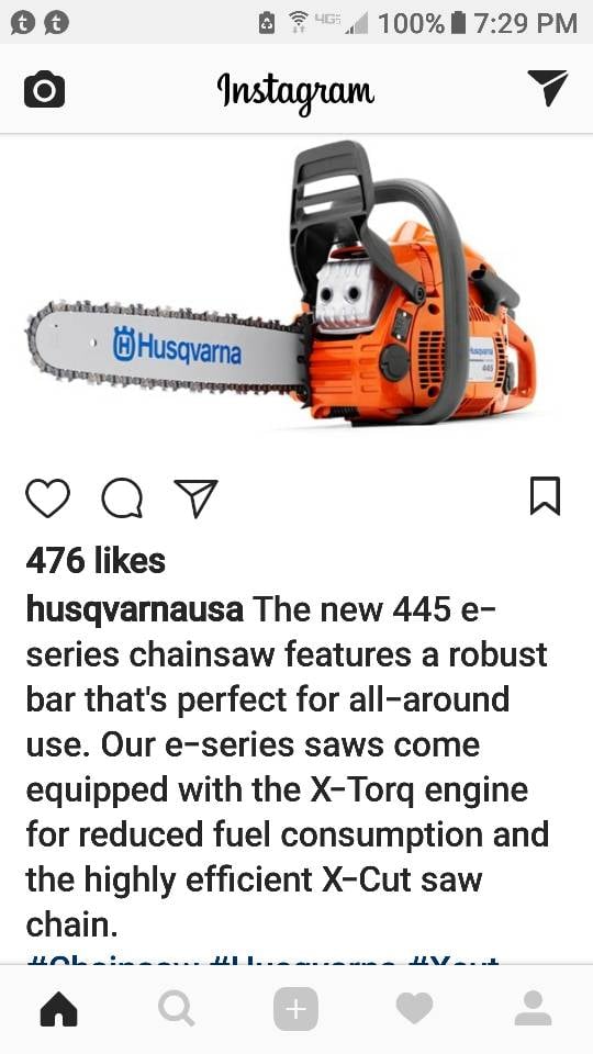

Is this a new saw? 445e?
No, not new but the 445/450 have been updated enough that they changed the model number. Changes are moslty to do with easier starting.
New coil that fires at 700 RPM, new spring assist starter that doesn't stick out twice as far and no deco valve.
No deco makes it easier to start?????????? Well a deco makes it easier to pull over, but not necessarily easier to start because of the reduced compression. Especially for people who can't snap the rope real quick. So, the thinking is the spring assist starter and a coil that fires at lower RPM, but at full compression is the way to go.

Thought the e stood for etech which meant cat muffler????
No, just an e doesn't refer to e-tech, it is about other (usually unwanted by people used to chainsaws) features of the model. I don't remember the details for sure at this point, but on the 450/445 I believe it is about a "tool-less" chain adjuster and maybe some "start help".
It should be easy to find out for sure by going to the Husky web-site and look up IPLs and/or operator manuals.
