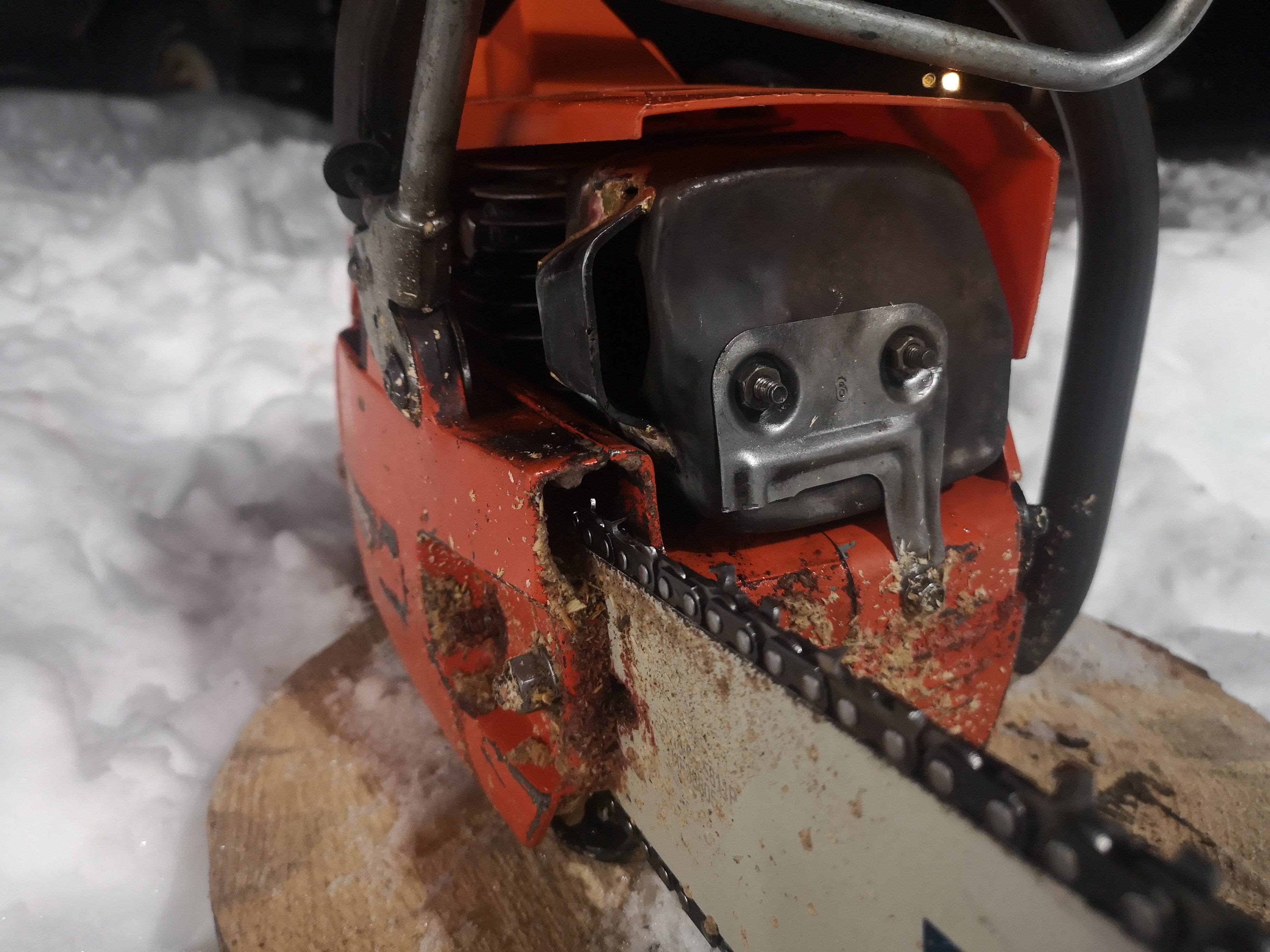

I whipped this one up last night for this 61 to 272 build. Wasn't anticipating running the 268/272 style top cover so I started with a 266 muffler that had already had the deflector in the opening removed and the internal baffle punched out. Can see daylight through it. Deflector is a piece of a bed frame leg I had laying around.
