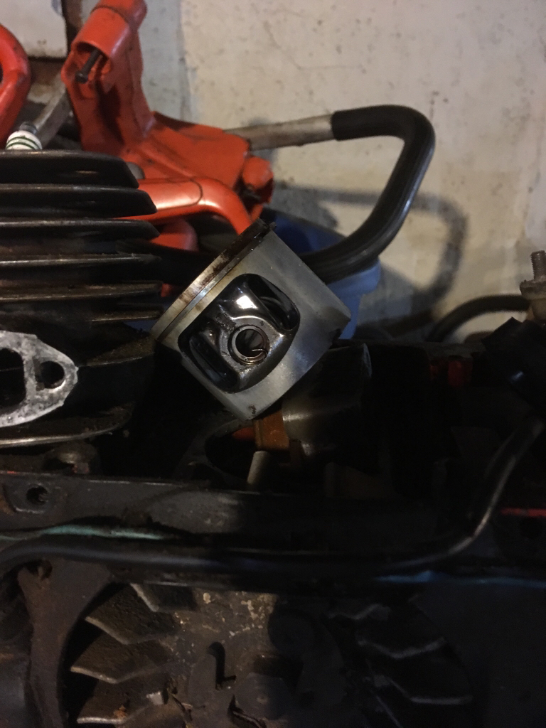

One difference is the piston. 266se had a windowed full skirt piston. 268xp has the normal windowed piston. Not sure when this happened in the 266se, 266xp, 268xp lineup
Weird. I’ve got a 268G here that has the full skirt piston

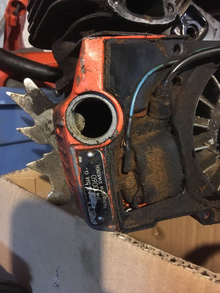

Wouldn't a 268G be an open port model with heated habdles?
Who knows who’s been in it. Recoil says 268xp
I don’t see heated handle switch but I need to look again

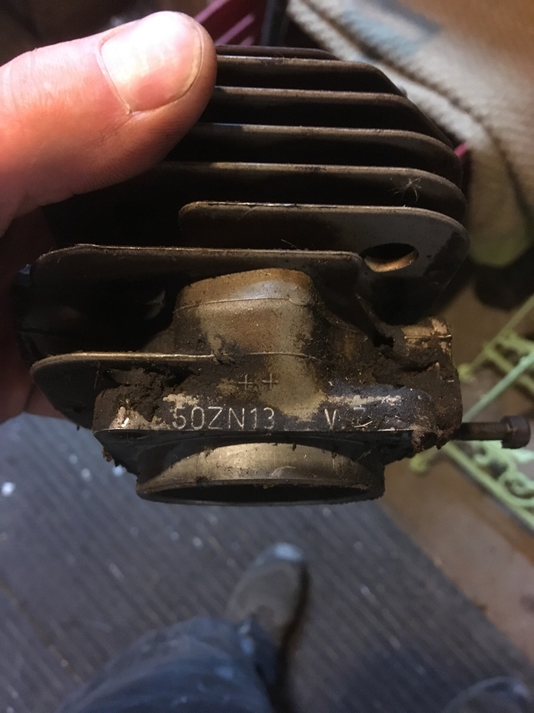

In addition to that (and likely more, that I dont recall) the cylinder is different, as the 268xp has larger transfers (can be seen from the outside, by the size of the bulges over the transfers), and the specs show a .2kW higher power rating.
Also, as far as I know the 266 never came with the one piece coil and corresponding case etc.

Thanks Bill
I guess someone has messed with it
In the right direction, though. Other than the piston, ime. It's worth about 500 rpm to replace it with a 268 windowed meteor. Not sure if its the windows or the full skirt that slows it down

A 266xp from Meteor is full windowed. Wether or not it's just a 268xp piston in another box I don't know. But pretty much what is from Husqvarna.
Yep. I was referring to a windowed piston like what's in a 272, rather than the windowed full skirt variety like in Dan's saw
