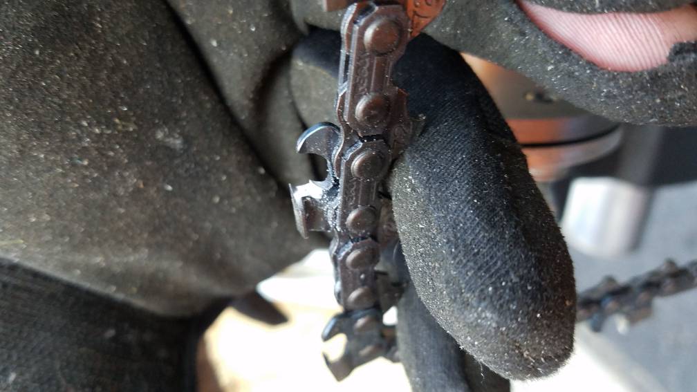

Here is a photo of my first attempt at square filing. Lol
I know, I screwed up. I gotta go back and try again.
The videos done make it look fairly easy. Lol
Sent from my SM-G930V using Tapatalk
Not bad for the first try Jeff, mine was way worse! Keep at it man.

Nice. Got a photo of the tooth?
Saw sounds like its turbo charged. [emoji106]
Thanks, my DIY woods port got her going pretty good I think. I'll post a pic of the cutters when I get home tonight around 1930. You'll get there man, try to keep the corner of the file lined up with the corner of the cutter. It's not easy, just keep practicing and before you know it you'll be "square"...lol

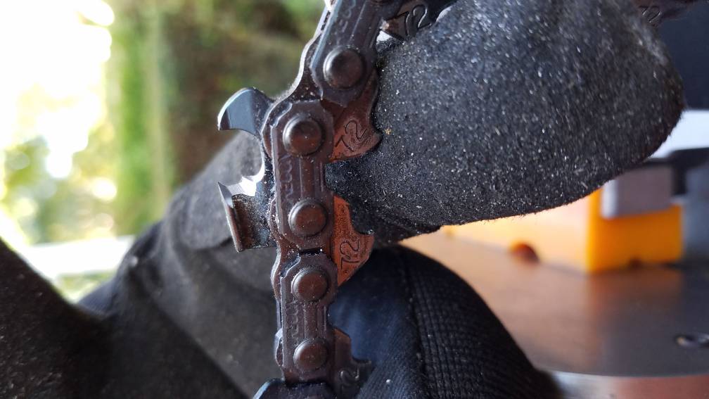

I was aiming for that kind of tooth when I filed mine. Lol
That is sweet. [emoji106]
80% tooth + garbage raker = square corner/forward lean/intersecting line on the low side.
That POS self feeds now!!! Did that one on the grinder. Pink wheel.
Too bad it won't last long.
