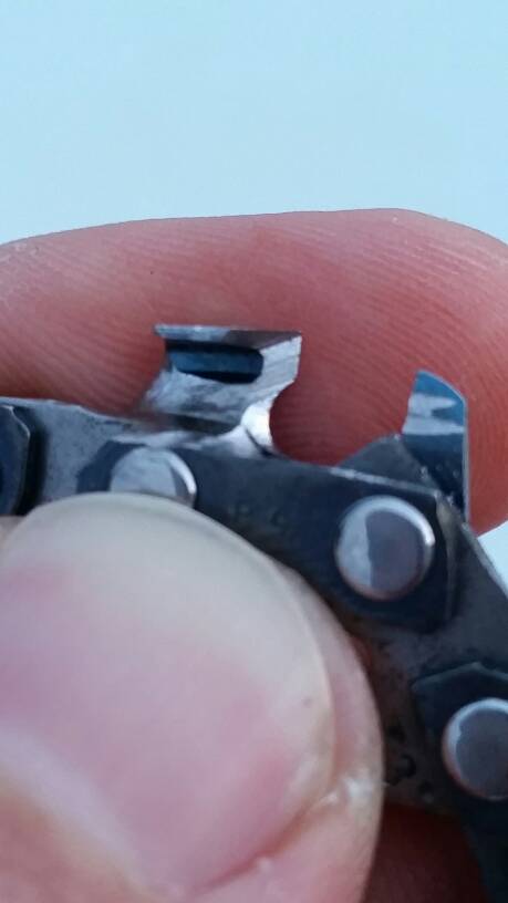

Top plate is thin enough that his file had to be over the straps
Look above back rivet. If you look closer at the other pic, the same mark is there...just lighter

Kinda new to this square file stuff, but judging by what I'm seeing here you want live edge file's not the smooth edge ones I run for dropping rakers. Or am I wrong?

Yes, chisel bit files..
Hard, square corners..
The straight edge side plates sever the wood as opposed to ripping through it.

Chassis work takes forever! Lordy! I wanted to see how it cut before I got too aggressive with it. Might bog down the lil 241 more than I'd like
Keep the rakers high..
That crap is agressive.
Fine for white pine, but will sap your power in gummy stuff..
