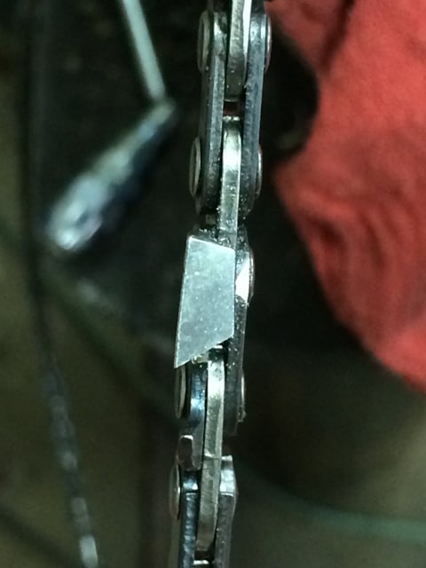

Thanks. Raker hight was .025. Would you call this a aggressive angle? I tried a round filed chain also at .025 and it was no comparison. I did end up cleaning the gullet some.

Thanks. I'm learning to square and want to find out what works. My last few chains with the rakers lower fed to fast and wanted to bog some. Smooth but bog.

I'm finally getting my left hand to follow orders! Funny thing is the cutters I'm doing with my left hand are now looking a little better than the right hand cutters. Probably because I'm going slower and concentrating more with my left.
Left:
Right:
