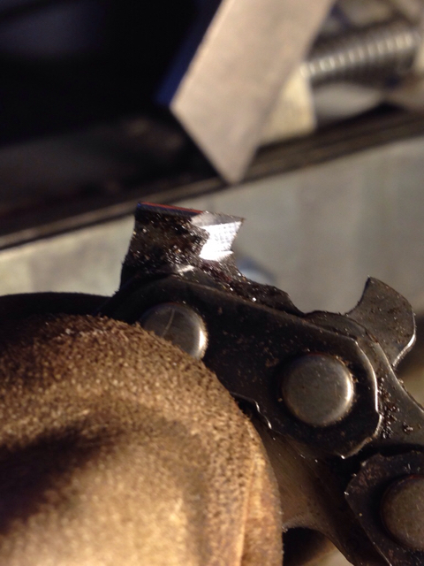

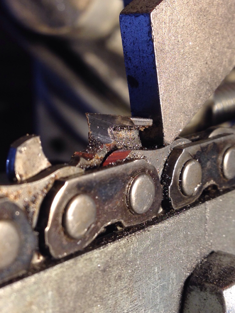

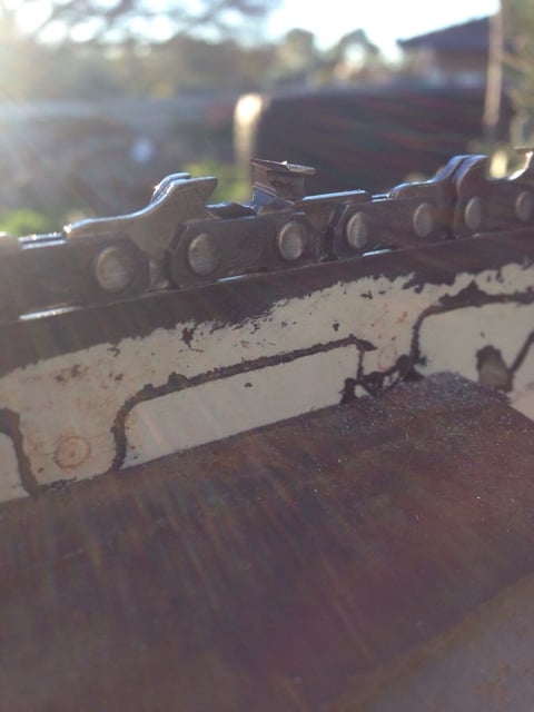

Gave it a go this arvo. Was determined to get it to work. Have tried using the bar mount jigs but just tried free hand and clamped the drive links in the vice. Did a 16" .404 and a 12" 3/8lp

I dry fit the file. Looks like it will lay right in there. Jasha said he uses a six sided to touch up.

This is the grind (Jasha) I'm trying to follow. Got a six sided file. Got one of @Homelite410's jigs on the way. Suggestions?
Ross, I have found pointing Mikes vise straight out to me works best. I normally only use the very closest clamp to me. Ill file the left hand swap and do the right then progress the chain to the next two cutters.
