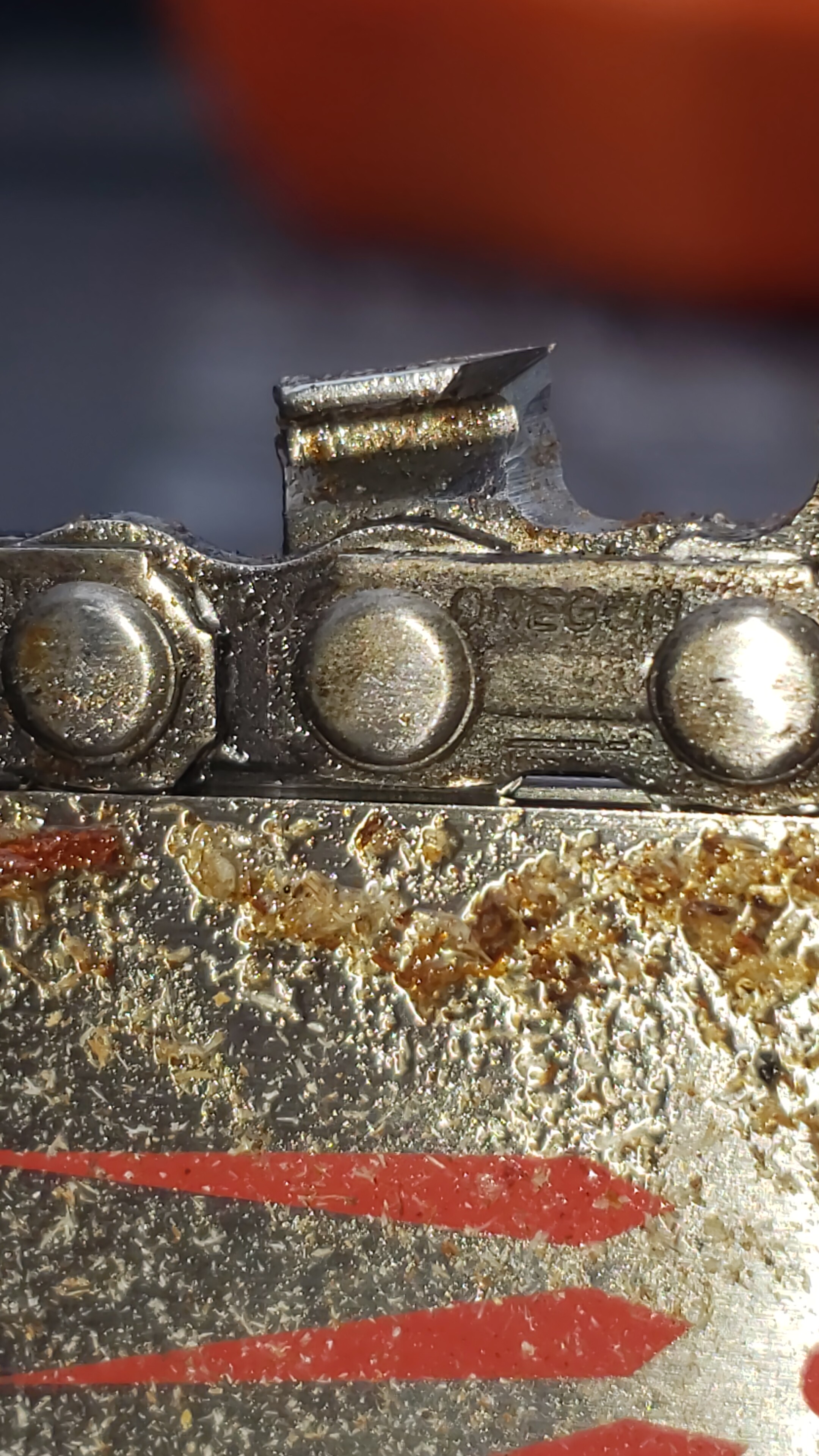

Yeah the rakers are a bit high on this one
I always lmao when people comment on the look of a rakers height. My .03, don’t touch them till you run the chain, then adjust to get it to load the saw the way you desire. Small rim can take more bite, if you’re running 8-9+ you’ll [typically] want less.
I filed the chit out of a build-off chain, then tested it a bunch. Ended up sending it without touching the rakers and it did very well!

Good point. Im gonna be running a 7 on that 562. Ill try to get er done today and do some testing

This was one I converted a while ago. I'm still a complete hacka.

1. Don’t post pictures of any cutter unless it’s been filed, don’t ask me how I know this
2. File ick ........ some here don’t like that stuff
3. Top outside corner is most important, inside corner not so much
4. Some beaks are intentionally used, application is key
5. @Homelite410 makes killer chainvices that are sooooo nice to use, just about a requirement, unless you get used to using vice-grips for each cutter
6. Practice makes perfect
