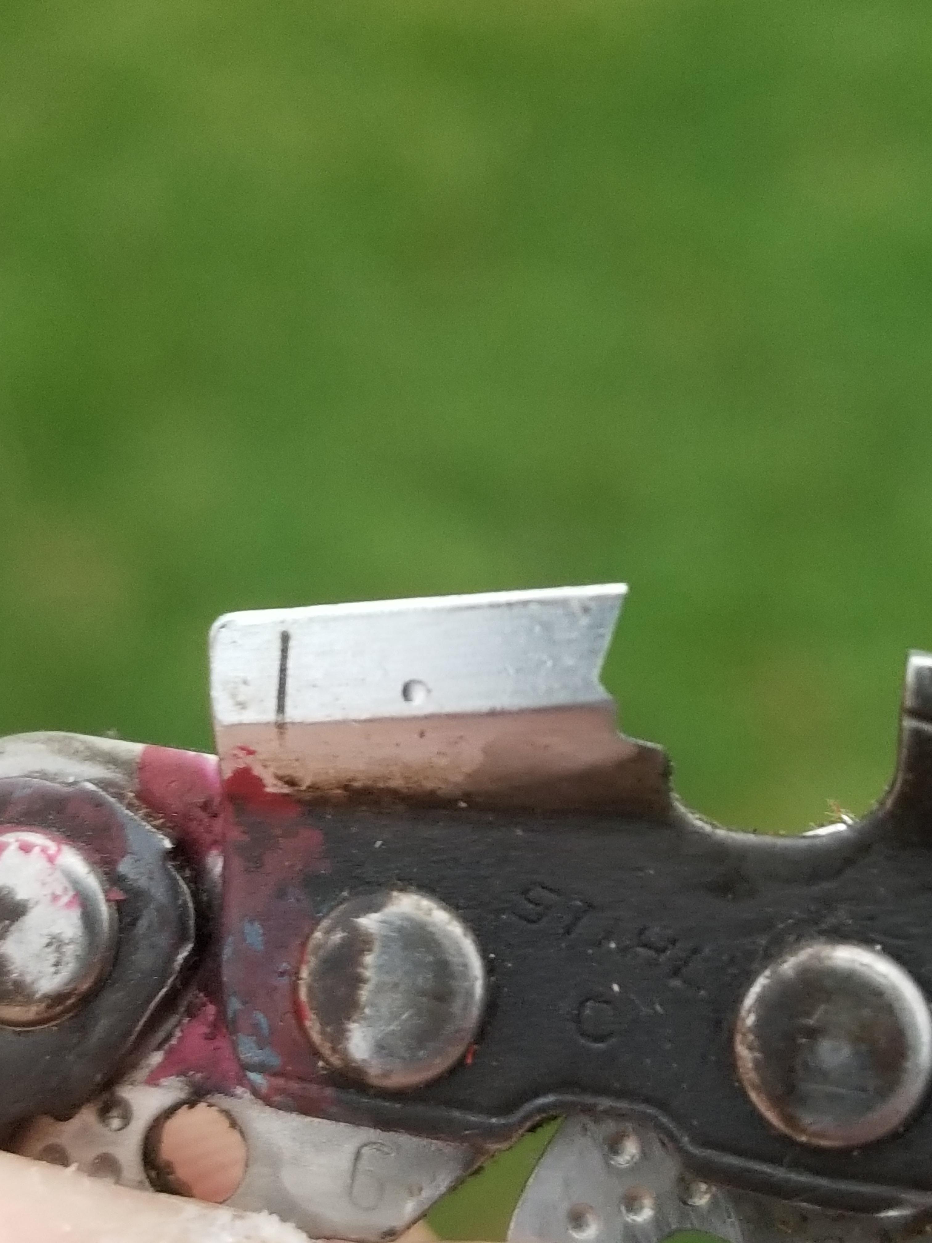

Practicing some more... tried my best to do what Deets066 described by removing that “shelf” between the square and round portion of the cutter. Tweaked my angles some more as well. Almost “corner to corner”. I got a side about 1/2 done over a span of 5 hours and decided to call it quits lolE323083A-C50C-4BB4-A0D8-A8CCCA7487B9.jpeg 8B151364-FF6C-4775-A2A7-745483055A6C.jpeg D0FCEC67-9AE8-4A91-A8D1-03001DBCE52E.jpeg

Tried muh best to get all of the gunk off lop
Austin, one tip for getting a clear pic is to zoom in all the way, then back your phone up until the pic clears up on its own. Usually works for me.
Looks like you have one corner dialed in, and the other is low. Is that side plate still leaning back, or is it just the angle we're looking from?

Its the picture angle. I thought it was leaning back but I looked at it from the other side and it was fine. And that second cutter I went ahead and fixed it up AFTER I took the pic. Having brainfarts left and right

Sounds like me every day. Lol.
Nice work Austin.

Thanks Dan. It might be... I’ll check it tomorrow.
Get a pic from the back.
