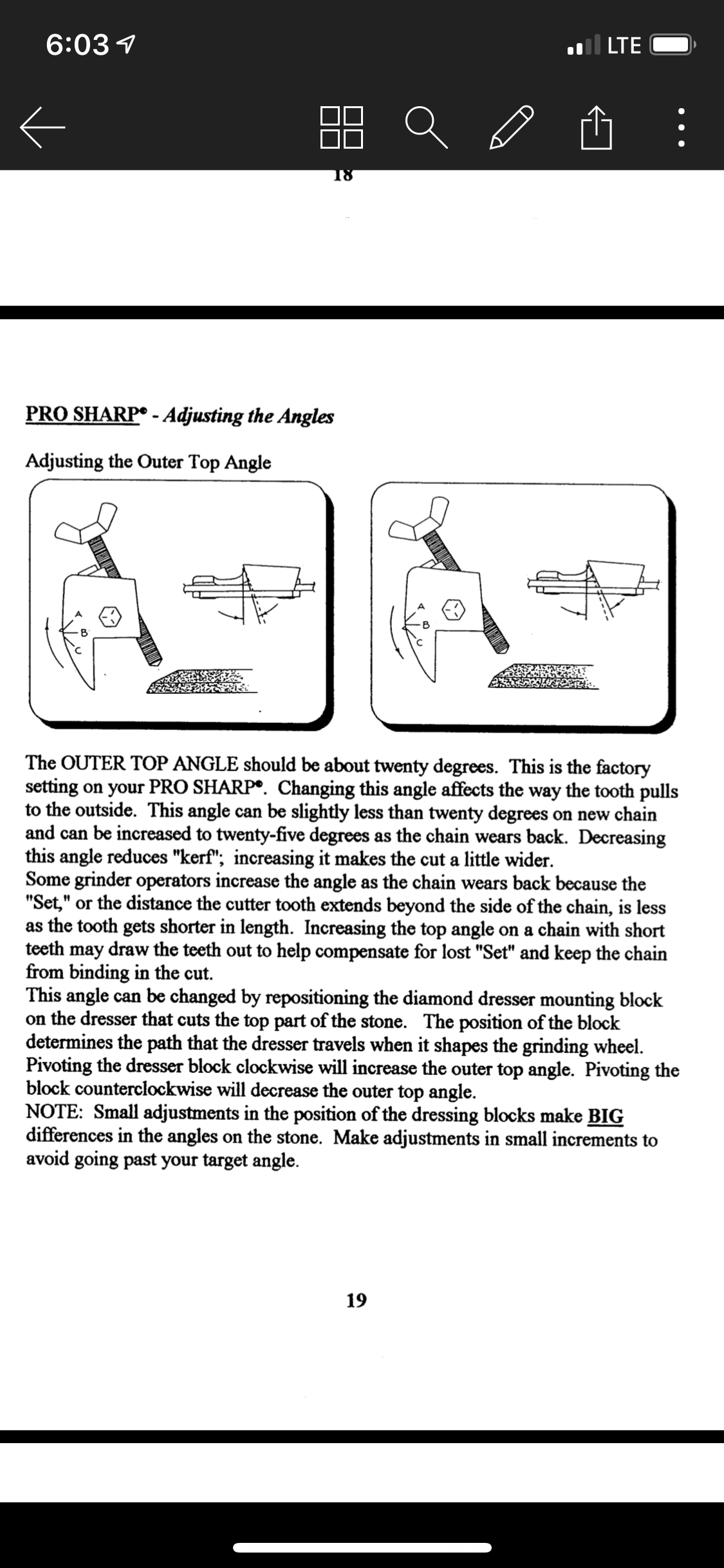

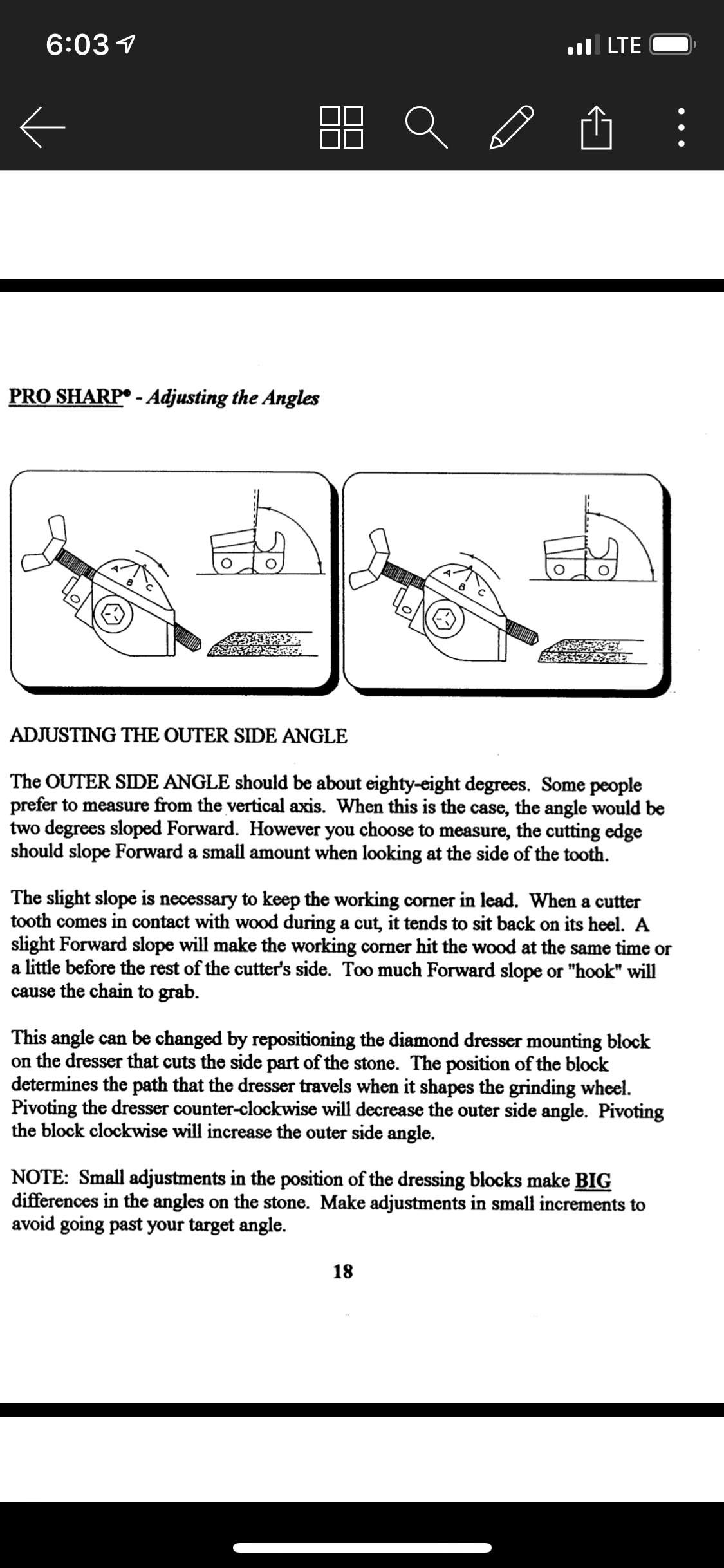

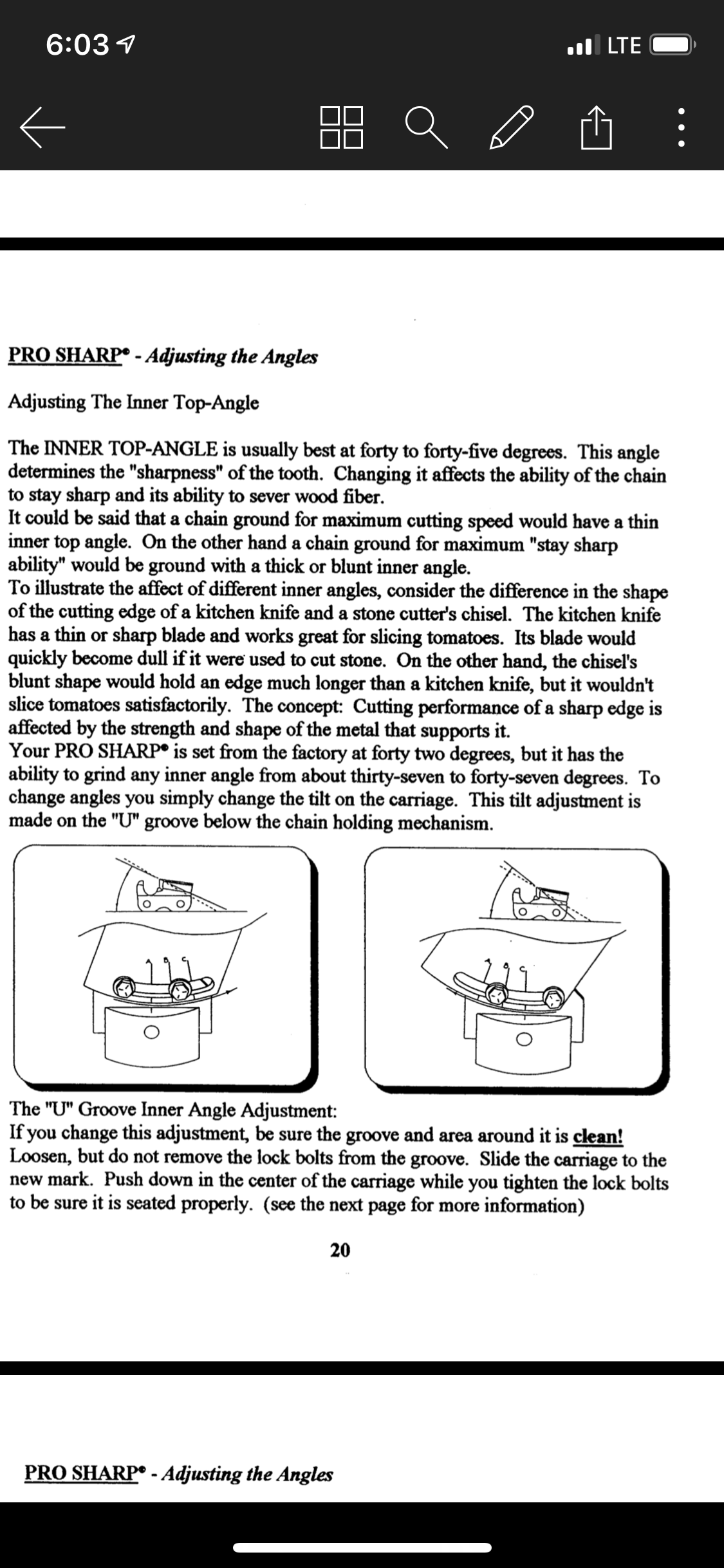

Skeans1
11:24 PM
6510
Jun 24, 2018
1,735
9,537
Oregon
Nice. Looks like 12-15* top plate.
I'm still trying to figure out what the top plate angle does to the cut...
More or less... Faster or slower...Better or worse...Stay sharp longer or less...
Thoughts???
Does this help any?
