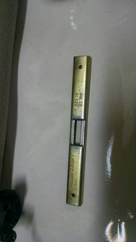

Is it progressive like the Husky or fop?
This is what I normally grab when I use one. I have the husky type also.

Go to 0.030 or 0.035
If you could see how the angle changes as 0.025 remains constant as the tooth gets filed back to the end of its life, you would switch to the progressive guide or switch to nailing 5-7 degrees
I'll give it a try. Thanks
