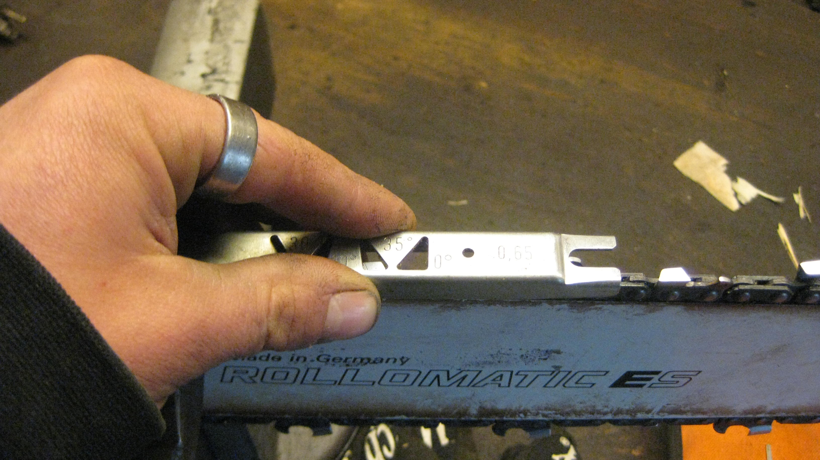

I think hard is 25. But it's more about the angle of the dangle... @ any rate, that method should stay good with a grinder where all cutters are equal, but if hand filing, if the cutters get different lengths, should start cutting crooked. Which is why I like the progressives.

Why not use one of these? (not my pic)
I haven't tried one of those I'll have to get one and I sharpen my chains on a simington 450. So they all maintain equal cutter lengths.
I have one of those. It gives .025 and they cut fine on the dogs, just didn't self feed (probably because of angles) unless I went lower. I need to get the plate tool we have been talking about.
Husky roller guide is a pretty handy quick check tool.
