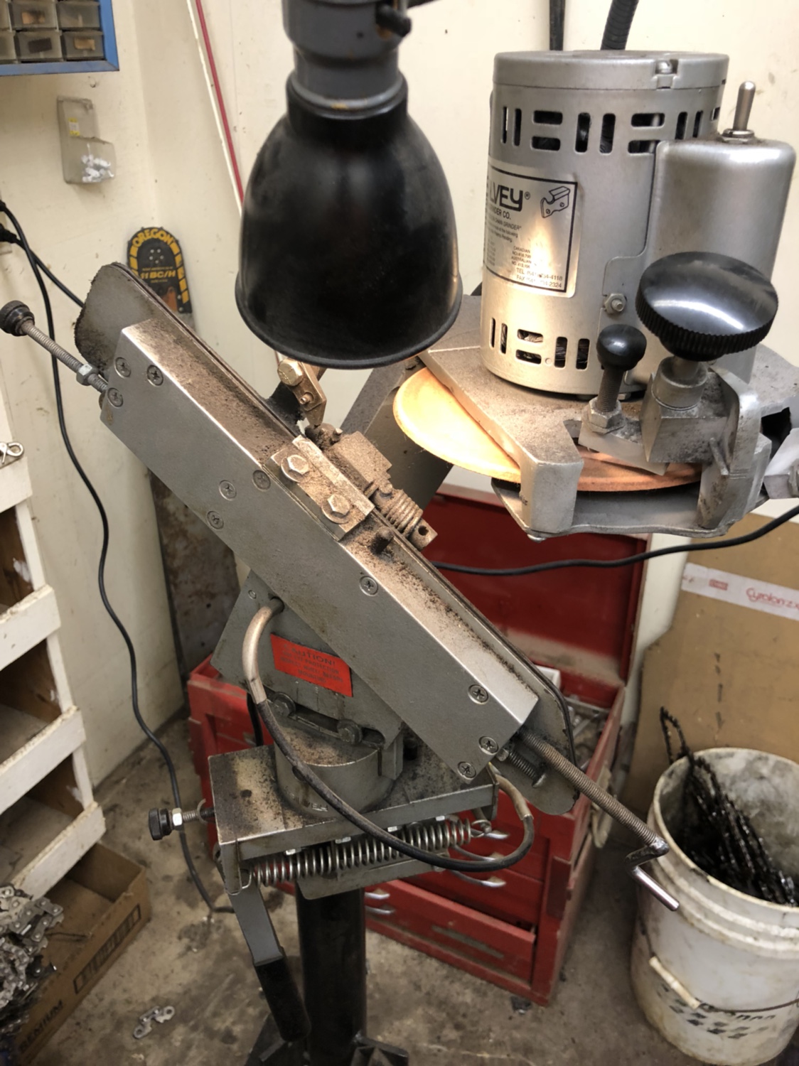

I’ve always hated the swing arm style grinders compared to the upper end grinders the repeatability just isn’t there and there’s no hold down mechanism for the tooth.
I like to pull down on the chain to keep it tight against the pawl, works pretty well to keep the cutter stable.
The problem I've had is when I'm really hogging material the cutter heel can lift and change the grind.
To avoid that I just grind in two passes.
A better hold down for the cutter would be nice though.
The pro sharp has a hold down it makes a huge difference so does the way you can control how the can scrolls into the wheel.
Mike told me to squeeze both sides and rotate back into the pawl ............. makes a huge difference and works perfectly. Keeps everything pulled down and back, making for uncompromised consistency
If you flip those chain paws then it will hold the heal down. But then you run into the front of the cutter lifting.
