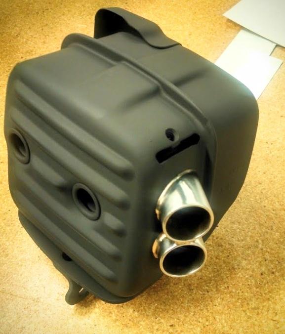

Good looking thread guys, Here is some of my work that has been finished with scotch brite on a bench grinder. if you have any questions I’ll be more than happy to explain my process!
That looks great! What pipe material is that? Where did you buy? And is that silver soldered on?

Dave, big thanks for posting this. Doc sent me a deflector, I wasn’t sure how I was going to attach it to a new G660 muffler. This technique and materials worked great.
Torch used was air/acetylene. Note how the brazing material flows into a nice fillet where the parts join.
Best results are obtained when all paint/dirt have been removed and metal cleaned with acetone before heating. Any oxidized contaminants will weaken the joint.

Very nice. What color did you use, if I may ask?
