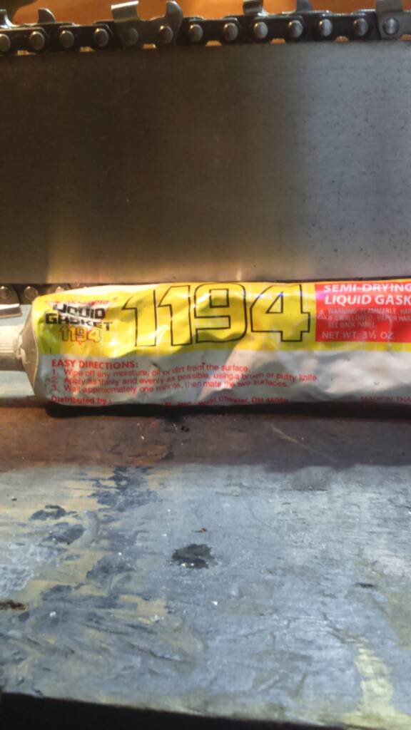

Three Bond 1184 is worth a look...it has been fine in 2 saws iv done with it...no issues .
This is what I use. A tube lasts a long time
In my search for the 1194 it "appears " and i say this reservedly ...that 1184 is its replacement ??. I pondered if this was ok due to 1194 being the tried and tested three bond i had seen many of you boys use and if it was the "Only" safe thing to use ...but ..it seemed to be up to spec . One of the Husq 42 specials done with it has done 10 hrs proper hedge line trimming ...no issues .
I know you can't buy 1194 any more, so you're probably right. I'm not sure why the numbers changed. That stuffs at least 4 years old, I bought two tubes and thats the second one. Only fault I can find is that it's very stringy.
I found motoseal runny, I like this better
Oh yea ..it can get you real messy if you don't have a plan ! Tried using my finger ..Hummm ! Wooden Tooth pick worked for me .
