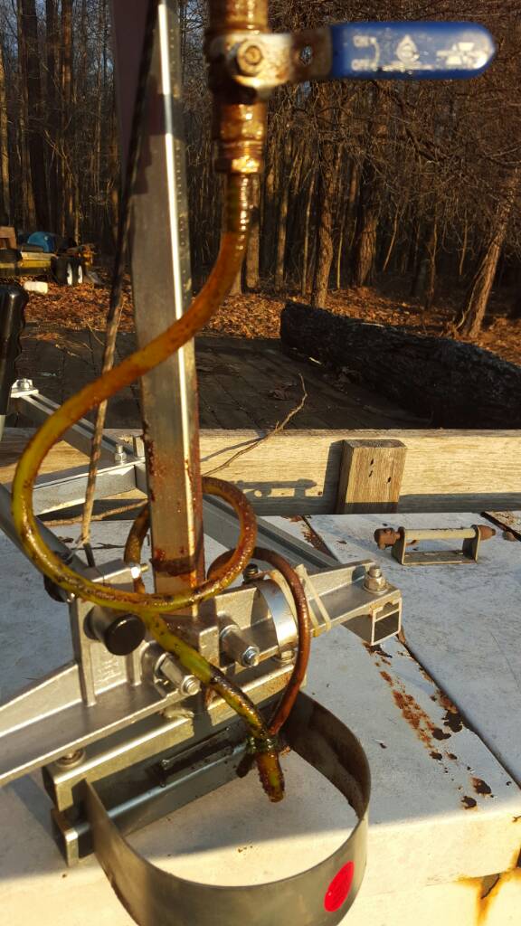

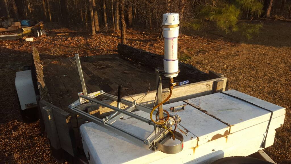

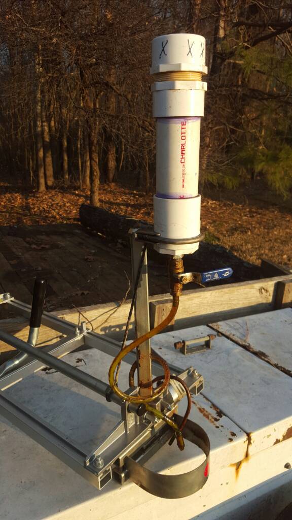

Aux oiler is a must with any Alaskan mill. Even a 32" on my 394's needs more oil as lots of oil is lost as the chain "makes the turn" on the tip. (You'll notice oil builds up on the inside of the tip guard.) I have some soft copper tubing that I use to hold my 1/4" tygon in place and just keep a puddle on the edge of the bar. As I always try to get one end elevated on the log, oil runs down on the chain and all is good. Drilling the bar is not that important that I can tell. It may keep the bar cleaner, but it will also limit how much oil you can flow too. I use a ball valve that I can really open up and flow some oil if I so desired.
