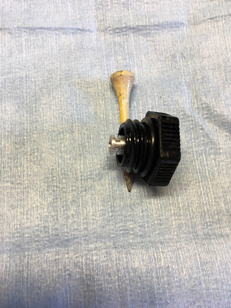

Source for the large duckbill for fuel & oil caps?
Still available. Still available at lots of suppliers.
https://www.jackssmallengines.com/jacks-parts-lookup/part/universal/610345
Homelite PN is 69451
On the oil cap, pull that aluminum plug out. It goes behind it. Fuel cap, behind the sintered plug. Pry it out with an awl. Both are the same. The Poulan valve works well in the oil cap if you have one but is a bit long for the fuel cap.
Poulan PN 530026119

Duh, I thought some large condom type went on the aluminum spigot.
We have a supply of both Homie and Poulan.
[emoji106]
Thanks bud.
