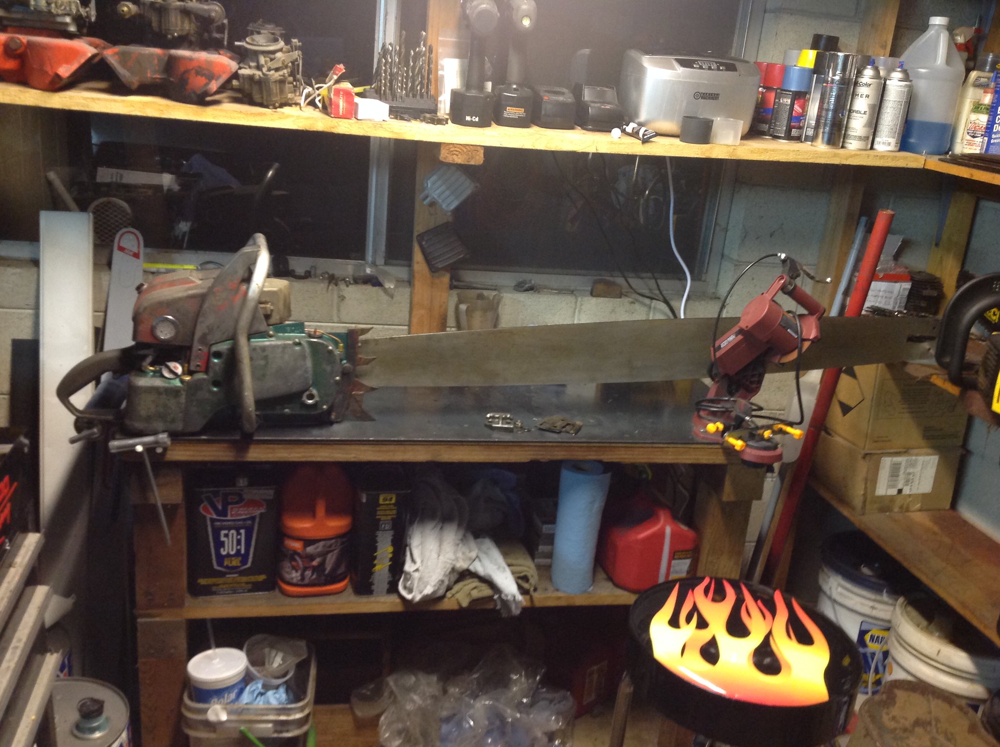

Got me a big one awhile ago. Decided to pull the trigger and restore this one to.
Had super low compression and piston/cylinder wall condition had me worried at first as the scoring on the piston seemed bad enough to make me thing plating was gone on the exhaust side.
SO....a half day at work and unbearable curiosity......I took it down to the frame to find that the piston and cylinder are in Awesome shape. Ball hone cleaned the cylinder walls right up and the pistons scoring doesn't catch my nail.
Reseal, rering, and repaint it is!
May as well start with a picture before I tore the beast down.
001 by TJ McCauley, on Flickr
The internals on this saw are in amazing shape. I'm wondering if it was rebuilt once before or just kept in a dry place most of it's life.

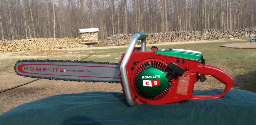

The 990g has been on my short list of saws I want to restore.
I always figured it would look nice next to my C9.
