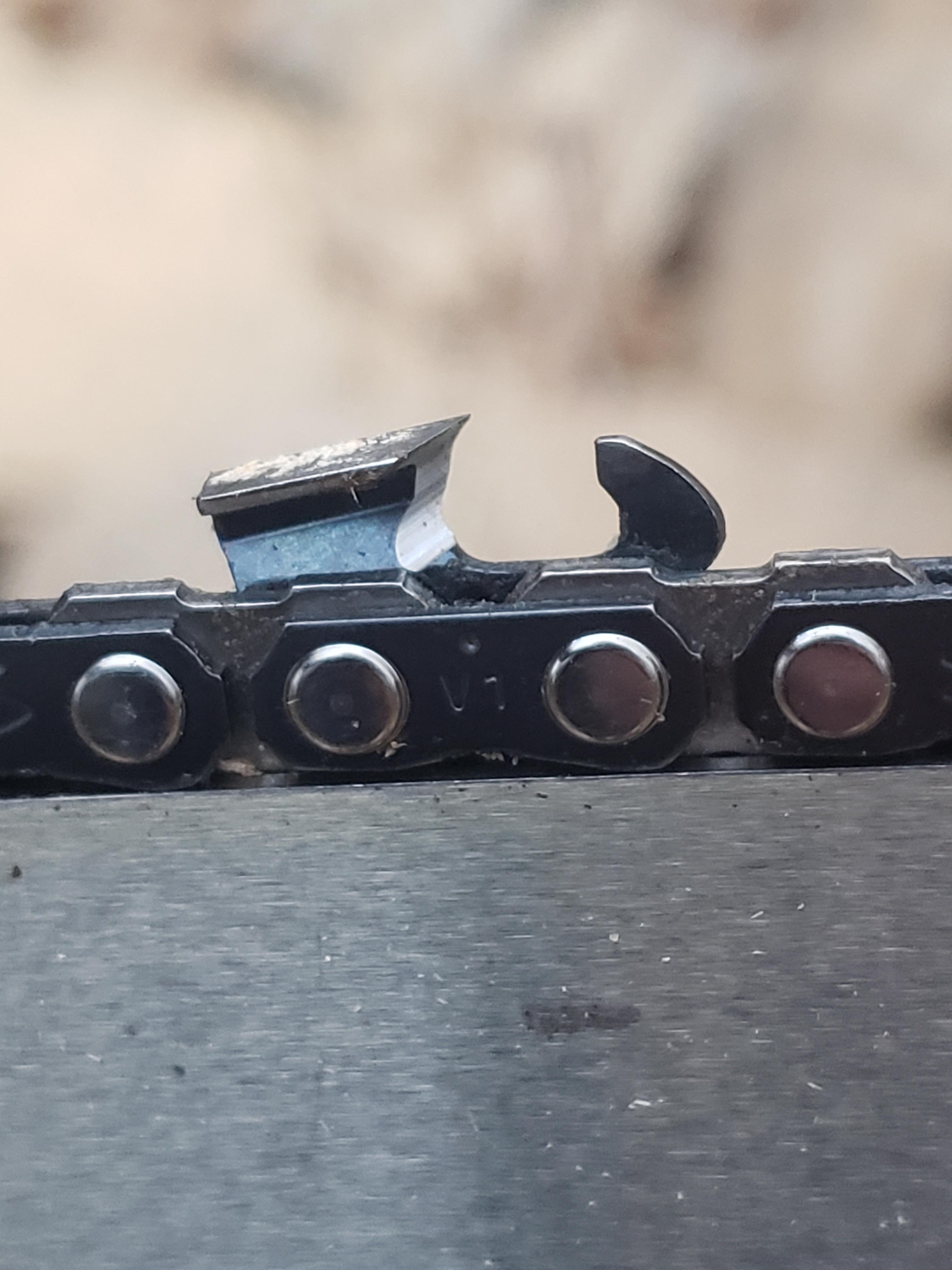

Go back to your dealer. Pick up a few loops of the new .325 Stihl RS Pro nk .050 chain. Maybe even an 8 pin rim. It is by far the fastest box chain setup there is for 50cc or smaller saws.
Your 241 will scream!

OK. Let's see here...
Kenny! Have you run the new Stihl .325 RD Pro nk chain yet?
How can anyone judge without running it?
I am sure you really liked the chain you mentioned here. Probably runs pretty dam good. BUT... Ya gotta run the new Stihl .325 RS pro chain before casting judgement.

That looks like Really nice chain. From the bit of reading I did on it, it’s available in full and semi chisel ??
almost look square ground. I’m definitely going to be calling both dealers Monday morning asking about it. This will still fit on the .325” laminate bars ?
Not sure if the RS Pro NK chain fits that particular bar.
full chizel
Have you? That chain looks brand new. Are you mad someone is disagreeing with you again?

I took the photo when it was new Bruh. You got no dog in this. Run along now.

I believe the .325 NK RS PRO is fill chisel only. The RS means full. I have not seen nor do I know if there is RM PRO chain.
