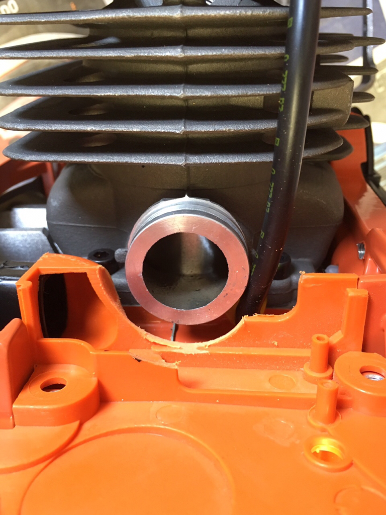

I have three Huztl 372 and an 365 that I bought complete. No big issues the first 372 I had to put a higher quality oil pump & carb idle screw kept falling out. Had to trim the tray on all three to give intake boot proper clearance. No base gasket on them. Also jug bolt broke after one month useage on first saw so I upgraded the hardware
67L36Driver
9:47 AM
596
9,675
41,665
Trimmed carb ‘tray’.
Even an OEM is silly close. [emoji6]

Those are like the G372xp's from Farmertec/Holzfforma. With those blocky handles and plastic carb bracket. Must be from the same source, and they are different than the kits or g372 power head with the low top filter. They obviously run though, right? I struggled a bit to find consistency in the carburetor settings from day to day on mine. Those are Also different than the kits. So I bought the "Huztl" gas tank handle and plastic along with chain brake parts to get it to the same level fit & finish as the Kits and G372's. Also it's getting the aluminum carb bracket. Bob found the cylinder flanges on his kit was too long, the trimming of that "tray" is a catch all solution....works. :) I like the G372 ( their supposed 48mm with a low top ) better as a starting point because it comes with the better tank/handle/plastic etc. Less finicky to tune, Better chain brake parts too. The kits are pretty much the same as the g372's but have 50mm top ends. That g372 ran well. No power house but it always started easy. It's biggest issue was the tray/boot interference and the bar oil slot in the case under the bar was off a little. Not enough to matter with a 20in bar, and nothing a die grinder can't help with.
