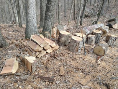

Good methods in your madness I like seeing a clean woodland on a cold winter day looks nice and dry
It usually stays fairly dry up there. It's a muddy mess right now due to freeze and heave every night. Did best I could around the woodyard to spread out sawdust. Beats slopping around. Used to use oak bark for floor tiles, but found it's better used as a base & top cover for stacks.

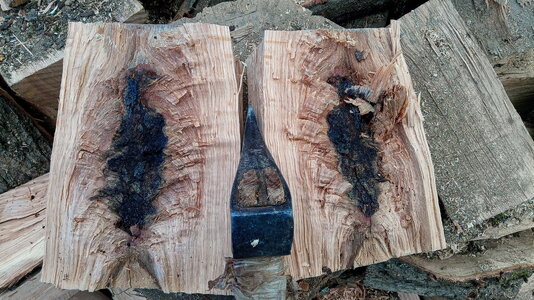

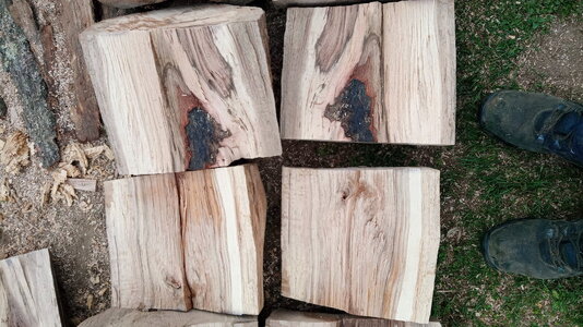

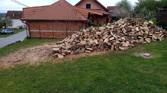

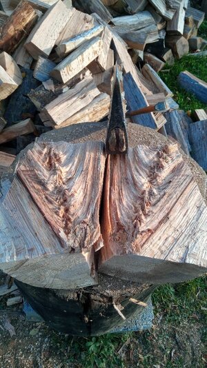

From this...
...to this.
Talking oak/turkey oak, buck and split the same day, the rounds will crack open much more willingly!
A round is harder to split as the open grain surface dries.
Dead standing "dry" trunks still contained moisture and were barely cracked from drying - they split well once bucked up.
All of it got split with a fairly lightweight 1.8kg ax on a 40" long handle - my Dragon Slayer.

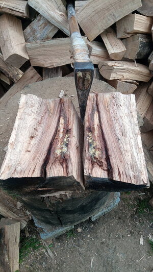

From this...
...to this.
Talking oak/turkry oak, buck and split the same day, the rounds will crack open much more willingly!

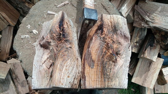

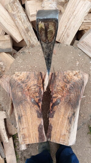

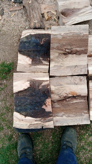

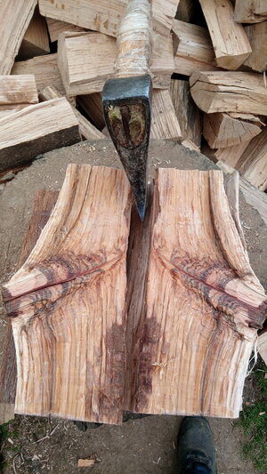

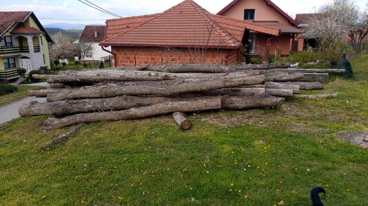

Two more beauties.
From this...
...to this with my E-Bay hatchet (debarking) and my faithful DragonSlayer.
For now, there is no chance I'd bother with a splitter.
I am enjoying destructive work!
