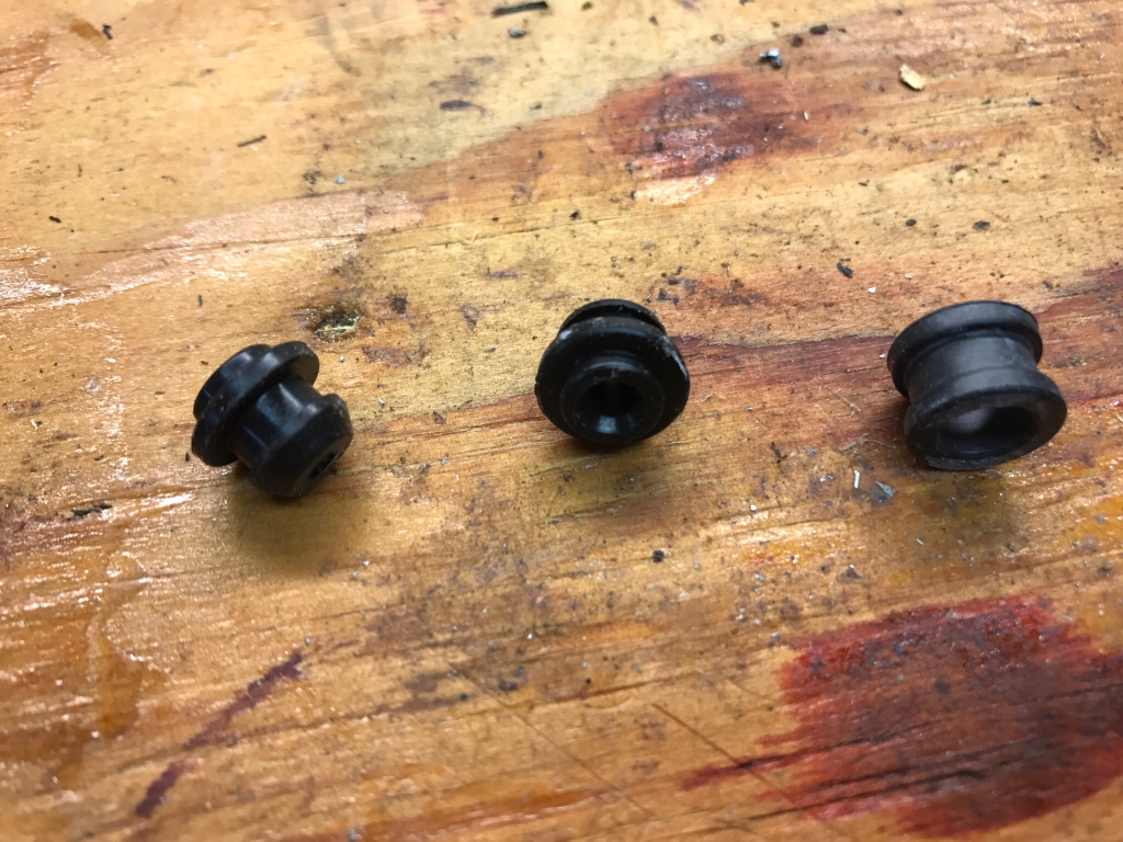

Pieces left over?
Where do they go or are they duplicates of something that came assembled .
Thank you
9:07 AM
48,770
201,577
top 2 go on front of tank housing
metal bushing goes on brake lever
the bellow goes on throttle rod
rubber bushing with metal goes under the flywheel side case as bushing for tank
second picture the bushing on the right goes through the flywheel case for shut off wires
not sure on the other 2 right off my head

Yep. Few part #s-
Tank ring is 1128-791-8400. They're usually installed on Farmertec tanks AND included in rubber kits. Save it for future 1122 or 1128 builds, they tear.
Metal bushing is 1124-792-5505. Without a bushing it's impossible to torque brake lever close to spec.
Top pic (next to ring) looks like rubber bushing that goes around metal bushing in brake. Part # 1124-792-5505. Hard to see on my phone, though. They sometimes come installed in brake.
