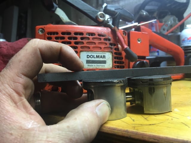

Ok so here is the dolmar ps540 piston.
It's got a
Flat top, longer and wider skirt, 10mm pin, single ring
Crown is shorter than the dome but taller than the edge.
But piston is .28 mm or .011 in larger diameter than the 44.7 piston which my calipers say is 44.58 mm or 1.755 in.
Al says maybe it can be turned down.

I have all 3 Pistons in my possession. 026/246/028.
I'll take some measurements soon. The 246 visually has a lower crown height as stated above.

When I put a wrist pin in both, the 246 piston is about .040 lower from its crown to the outer ring on the 026 piston
And about .100 longer on the skirt
The piston doesnt look to be of great quality next to an OEM or Meteor, so I think I will shelve the idea until I see what those with more know can possibly find.

The bigger issue I see with the piston is where the ring is set. It may be tough to keep it out of the intake port.

I'm trying to understand this. How does a lower pin to crown height help? Don't you need to take off that much more off the base to get the jug lower? Either way the squish needs a certain amount cut out to get the exhaust where you want. It seems to me a taller piston that was already flat would help minimize the base cut but the squish cut stays the same????
Am I confused here?
drf256
Dr. Richard Cranium
5:41 PM
319
9,667
63,788
Strong Island NY
Exactly Dan.
We need a longer piston wth a higher compression height.

This whole idea is geared towards swapping a different piston in a jug with a base a half inch thick on a 66. Hard to take 1/8" off a 1/4" thick base on the 26
