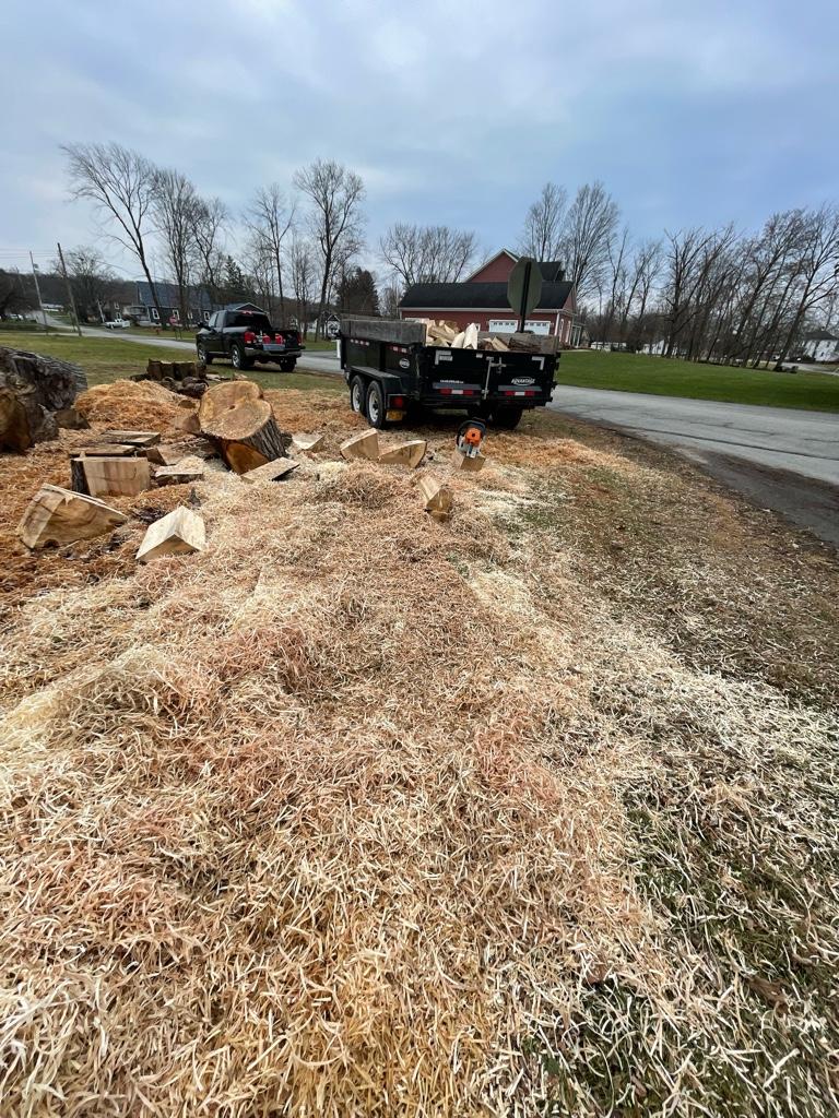

I might have to make something like that . I normally roll the logs I'm going to noodle on top of Smaller logs . I noodled some black locust that I cut about a month or two this morning. I used my 592xp with a 32" bar .

For noodling I can usually get by with a 25" bar and sometimes with just a 20' bar. My biggest headache is that the noodles build up and block the normal exit from the saw and start shooting out the front over the top. That slows things down and I usually have to go back to idle and pick out the blocked noodles from under the clutch cover. Some chainsaws do this far more than others.
I hate to show this, but one of my Stihl saws benefited from an old shop-modified clutch cover that exhausted the noodles right out and never blocked up:
I seldom use it and only on Stihls, but believe me, it does not clog up while noodle cutting. Once again, this was a salvaged cover.

I cut wood for a landowner that wants it cut at 26'' for the boiler . That's why I have a long bar .
