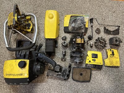

I need to get ahold of an IPL. I can tell so far, I need a crank, drive sprocket, piston….which I have a nos one. Hoping the cylinder is useable.

Yeah. Whoever tore the saw apart….either had plans for the crank…or it just didn’t get put into the box.

I have two complete saws.minus one carburetor. The one saw is in poorer condition than the other, so I'm not 100% sure I'll ever do anything with it. But the parts foe these are very hard to find. I've been watching the 'bay for years for a useable carb with no luck.

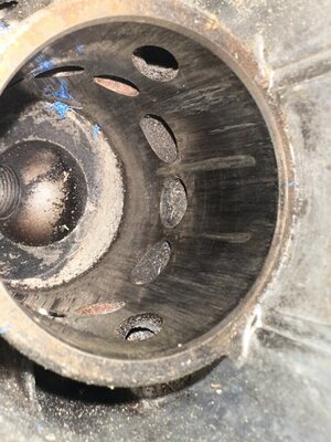

This is the cylinder though….

They are quite hard to find. I haven’t tore into this carb yet, to see if it is rebuildable.
I think the BP-1 cylinders are sleeved but @heimannm Mark can correct me if I'm wrong. I think I remember seeing oversize pistons for these on Ebay many years ago.
Yes they are sleeved. I did see up to .030 oversized pistons on one of the old mcculloch piston id sheets. Finding one, is a different story!! Lol

From my observation it appears to be of the time period cast iron die cast in alumnum alloy . As such if typical they may have offered over bore pistons at one time .However because of the very short time period it was in production it's highly unlikely to ever find any if they were offered .I have the piston charts on micro fiche which I'll investigate when I find the time .As far as the design it was an experiment that didn't work as intended but it was a good try .
It would probably be worth getting with Max the Mac Man to see if he picked up any when he bought Woody Strommen's inventory.
I know Mark ended up with part of Bob Johnson's inventory so that may be another lead.
