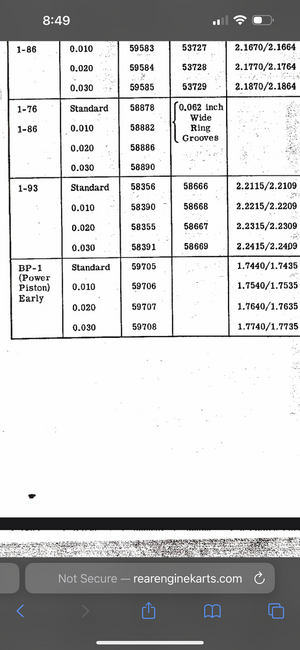

Here is a snapshot of the info I found online pertaining to the mcculloch part numbers.

I do show that I have one 59501 piston without rings, which apparently superseded 59705 because both IPL's I have (January & October 1962) say the original is not available and to use 59501. I did put one together using Homelite 12040 rings and it ran O.K. The carburetor was pretty rough but Brian Genrich's later sets did work in that one.

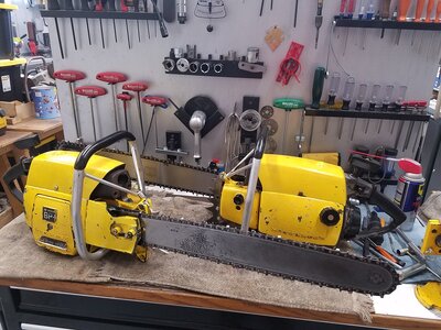

My two runners.
The first one that I got from Woody years ago is a lot more reliable, that's the one I will take along to a GTG. The other one with the paint on the air box cover lives on a shelf in the display.
My runner has a bit of a leak in the carburetor so I will have to take that one apart again one day and try to figure out what's going on.
I do have a few sets of Brian Genrich's carburetor gasket & diaphragm sets available.
