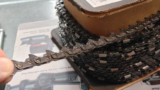

I guess it really depends on the person. I have a MS 261c with a 20" bar that I run 3/8 .050 full skip on just because. From what I understand longer bars benefit from semi to full skip because there is less drag with fewer cutters compared to full comp chewing through the wood.
I also made a 31 driver 3/8lp .043 full skip chain for a 6" Milwaukee bar that mounts to a MS 170....just because 🤣
