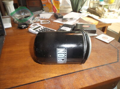

I'll try to do some updates on this Champion splitter.
I've been on a job for a week and a half. I didn't have a chain saw on the job so split a pine log that was around 8 inches diameter against the grain and it blew out the hydraulic oil filter. The hydraulic filter blew out before too. Fortunately I had a spare in the back of my SUV. I went out to buy a gallon of hydraulic, Lowes was all out though HD had it. Then when I finished I hooked it up, drove back to hitch it, then pulled forward missing the fact that the Belgian block would hit the splitter, and it damaged it so it is not driveable. Will look around for a welder, etc..
