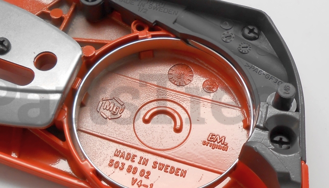

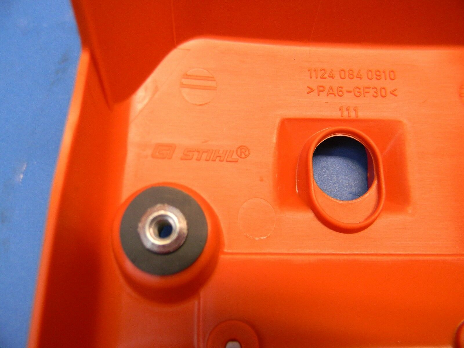

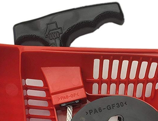

So they don't make some of their plastics as thick as other brands do. But to say it is a cheaper plastic is a lot like saying they are using cheaper cheapness. The reason Husqvarna and Stihl use any plastic at all is because it is dirt cheap compared to magnesium, aluminum, and can be formed easily in to complex shapes without having to do months of engineering QC for fit and function, and it lasts long enough. In some circumstances, it will take more of a beating than alloys would. They all use the exact same plastics - a glass reinforced nylon known as PA6-GF(20/30 etc etc)(https://en.wikipedia.org/wiki/Nylon_6). There is a rather thin range of plastics that will survive in the environment a chainsaw lives in, and as with most other industries, they've all resided to using basically the same thing - glass filled nylon. Pull your vacuum apart, your car bumper, intake manifolds, your bike fenders, motorcycle fairings, about anything you think is plastic used in the elements or needs strength is made of the same stuff. Which, of course, makes that stuff, even though it is a quality plastic - ubiquitous and cheap. Now - complaining about fit, finish/edging has merit. I am not impressed with the handles on most of the newer Shindaiwa's, but I can live with them. After all, plastic with sharp edges tend to go pretty smooth fairly quickly in forest work.
Stihl shroud:
Husqvarna(note the symbol for Magnesium on the cover as well):
Shindaiwa CS390SX starter cover:
Over all, in my humble opinion, your money goes a long ways when spent on an Echo product.
