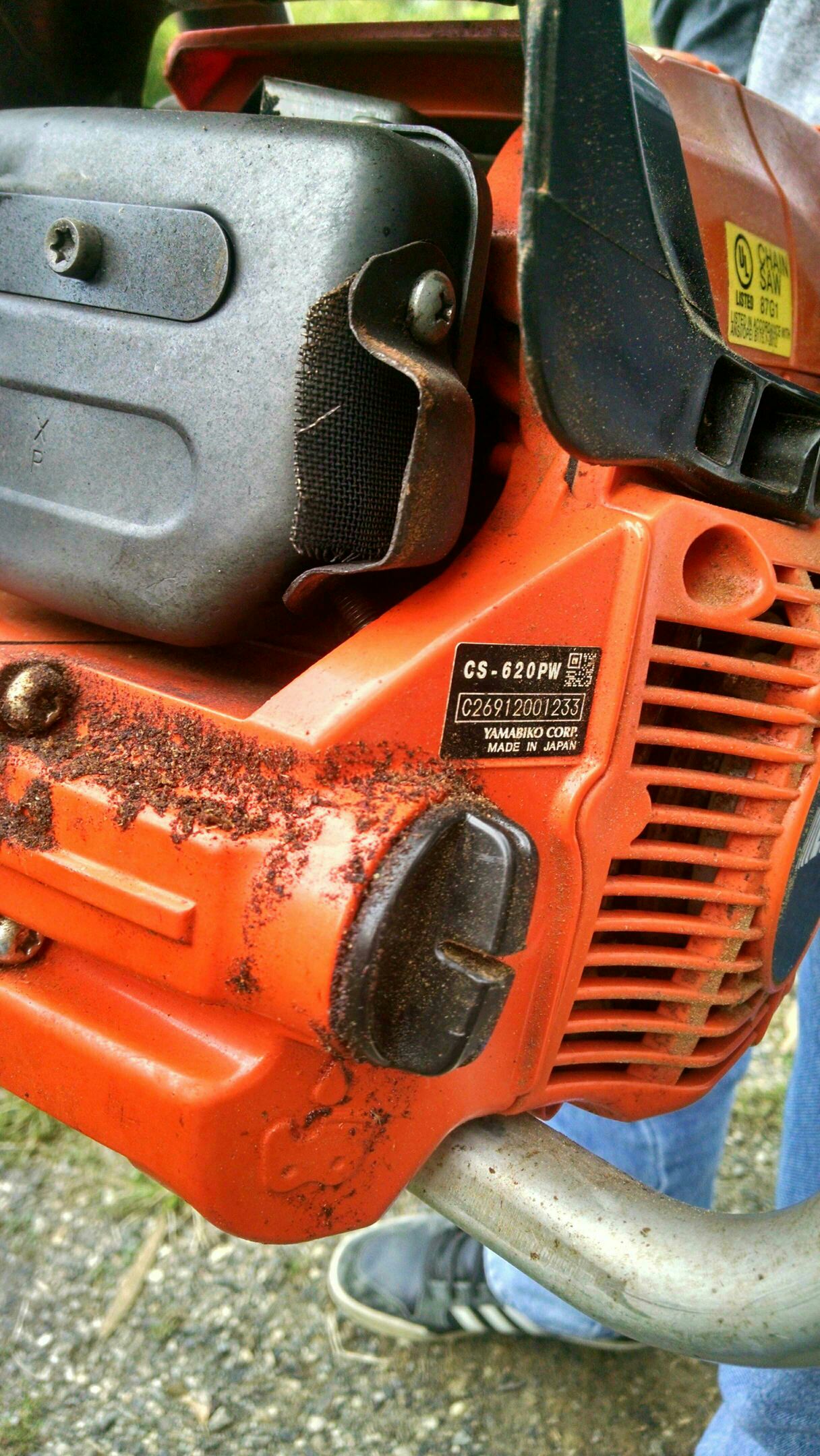

Hmm, they must have raised the entire port in the 620 jug..

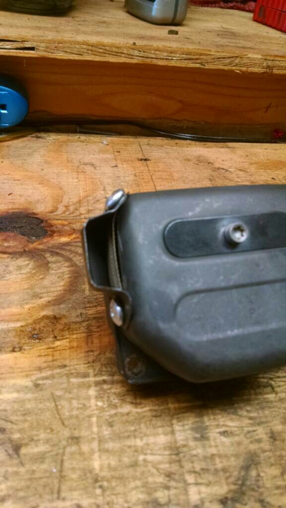

As for the muffler, under the factory deflector. There is a large square recess, with a 1/2 ish tube, above that tube is plenty of space to open, providing a nice stright shot out. Also remove the bottom portion of the factory deflector, seems like plenty of outlet.
I already opened it up. Holes around tube were opened with 1/4" carbide burr. Deflector is just the outer shell. It has to appear stock. People are really vigilant in the area it will be used most, due to the Butte fire. Was checked for spark arrestor and fire pump a couple of weeks ago. Running my 2171 the little fire house down the road heard me from about a mile !

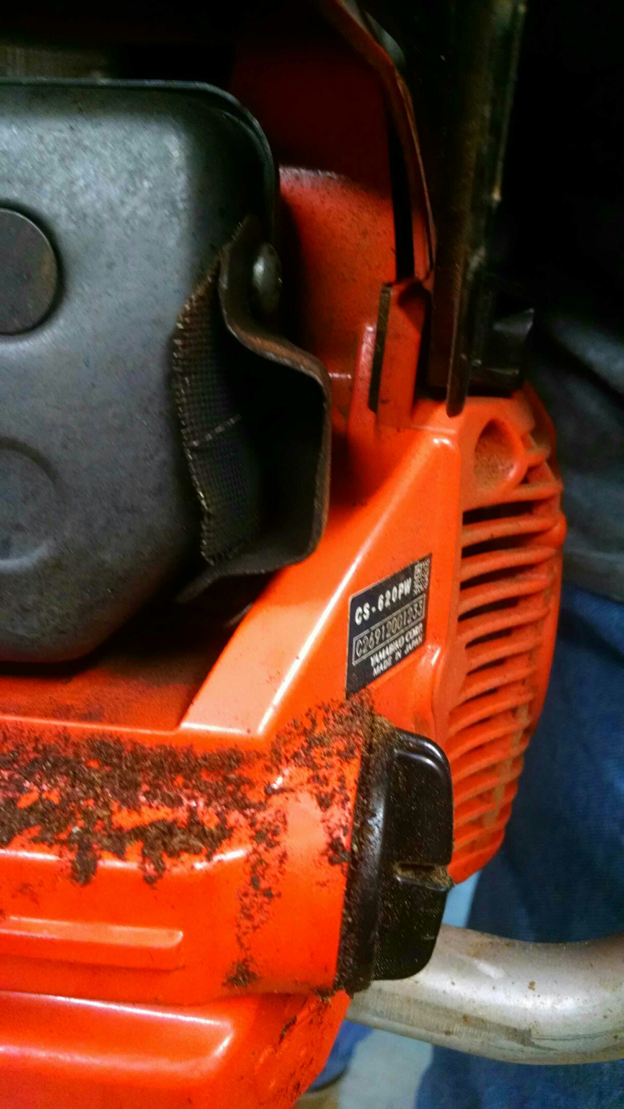

Here is one I done
took the inside out dang sounds good.

Good deal Red I think I did a little not too much.i got another in the shop that is in the other side off the muff
