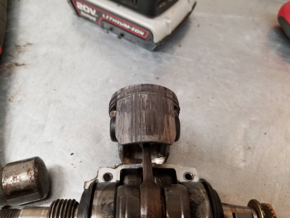

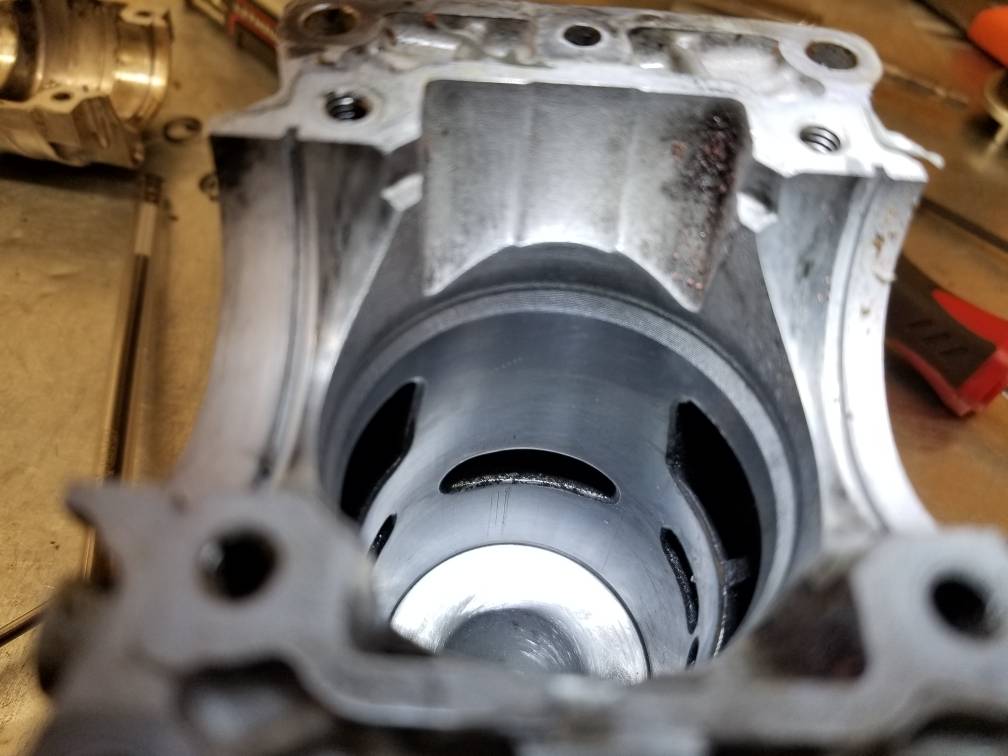

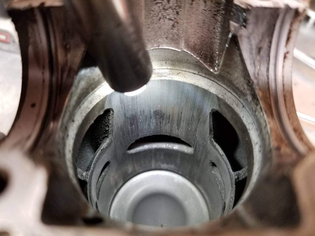

Think it cleaned up good enough to use. Just a couple light scratches above the port. Only other option is a 200$ short block. This one appears to have been straight gassed. Clear fuel in the tank.
Also the intake boot was torn along with the oiler damage from chain derail.
Well feed her the corn ffs
Looks like a good jug to find out the best numbers in. I bet you are close.
