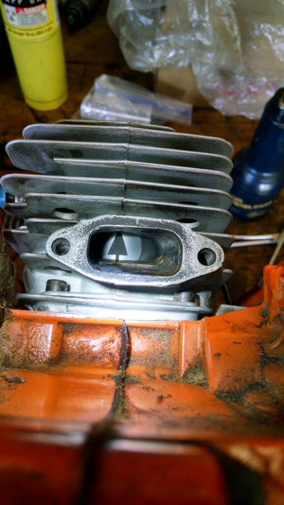

Ever tried making a popup?Compression boost without machine work I guess. Time will tell...
Im interested to see the psi bump it makes when u get it back togetherCompression boost without machine work I guess. Time will tell...
I did one in my 353. Gained about 10psi, it's a welded pop-up.Ever tried making a popup?
Me too.Im interested to see the psi bump it makes when u get it back together
How did u sand it and shape?I did one in my 353. Gained about 10psi, it's a welded pop-up.
Used the lathe at work.How did u sand it and shape?
Wow! I figured it to be at least what it was even before seating the rings?Initial compression. Very lightly oiled piston/ring. Also a little proof it's in there. Lol![]()
I'm hoping for 180. Someone said static compression could be lower due to the thin ring. IDKThink it will hit 180psi?
Ive seen worn cylinders with no scoring after a good honing or emery clothing pick up to 30psi. Did u hone it?I'm hoping for 180. Someone said static compression could be lower due to the thin ring. IDK
Also this cylinder is well used. Not scored but she has some time on her.
Scuffed it with some 320 grit.Ive seen worn cylinders with no scoring after a good honing or emery clothing pick up to 30psi. Did u hone it?
