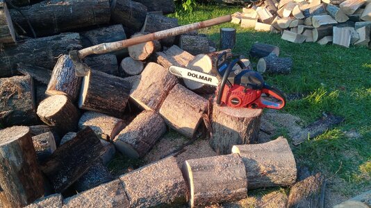

Hi Kevin!
Got this little beast out for play last Friday.
Ran a tank of fuel through her, oak logs.

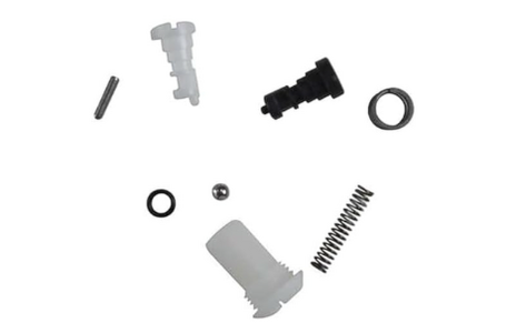

Yes, pump repair kit part number is:
030-245-070
Wouldn't really know about retailers, I get my Dolmar fixes from Germany.
Technically anyone could send You the kit, although shipping would be the price of the kit or more.
