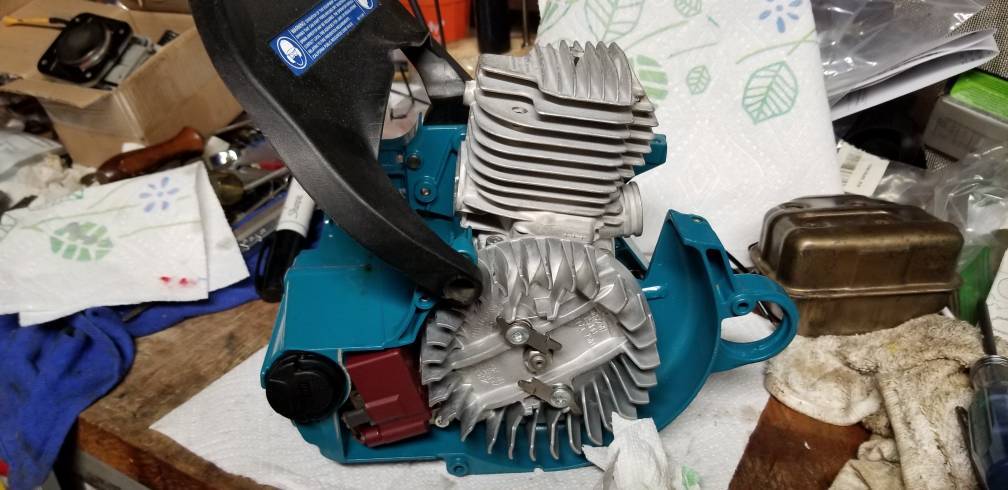

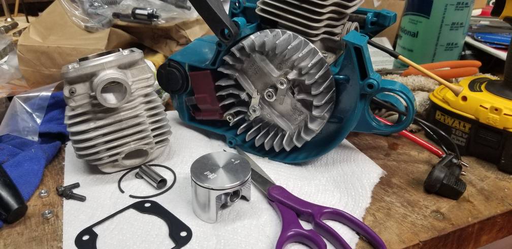

I got the NPW bb. Same exact saw base . 6401 :D
Edit:eek:
I just realized it might be the 6400 bottom I had. Red coil was already on it? Does that help? :-)
Above my pay grade Kenny! I only ran the saw for less than a tank as a 6421. It ran really good for a stock saw. Cant wait to see how the 79cc runs! The OEM 7910 kit was $166 shipped earlier this year from SLE.

What's your impression Dan, how does it compare to your other ported saws.
Time to update the YouTube avatar?
As expected it's very smooth! It feels really strong and can't wait for some tanks to get through it! I got a 24" Tsumara bar and it will be better suited than the 20"! I left that Ash log where is was so I could run the 7910 in it when the time came. It's been there a while!
