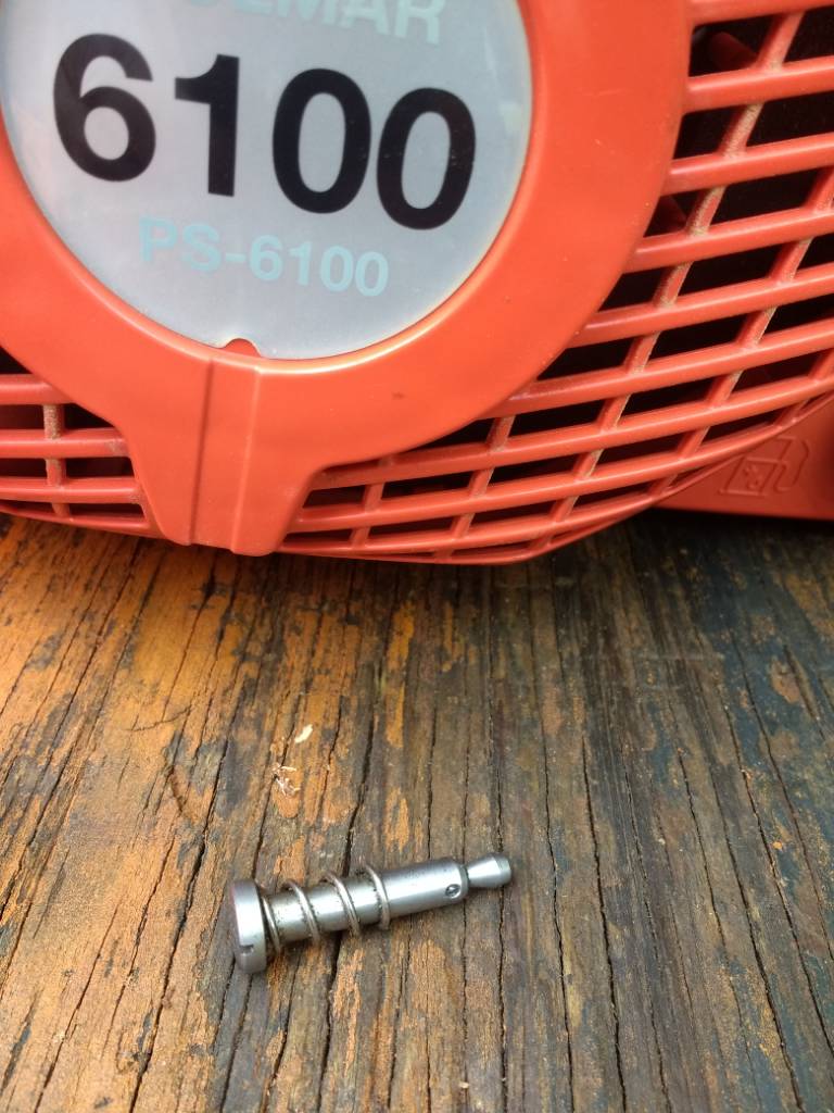

I asked this question on AS but never got a response so I will ask you guys. I fired up the 6100 and felt something hit my foot. I looked down and saw the oiler adjusting screw lying on the ground. Is there a way to repair this or do I have to replace the whole oil pump. Thank you.

Looks like the cross pin in the shaft is messed up. Can you tap it out and replace with a small roll pin. Looks like the pump was used on a bunch of small dolmars
Thanks for the reply. I thought it looked like a pin broken off on both ends but I wasn't sure. I've had this saw 3 years but only put 5or 6 tanks through it. It has never oiled like I thought it should. It would just sling of a very fine mist with it turned up all the way. I didn't know if it messed up any inside the pump or how long the pin should be.

Here is a shot of the pump....looks like the pin has just moved or sheared allowing the adjuster to fall away. You at least seem to have the spring so worth a go I would say.
Thanks. It looks like I'm going to have to remove the pump to see if it can be fixed. So I'm wondering if I should just go ahead and order one and replace it since it never oiled that good anyway. It may have been a bad pump from the factory. The cheapest I have found one is $25. That seems a bit steep to me but I never bought but one oil pump before and it was Chinese after market for a Husqvarna.

I'd replace the pump and look into fixing the used one.
I don't like fixing something twice, I replace with new and I'm done with it.
At the end of the day my time has some value as well and I can't hardly charge an hourly rate to myself.

Poor oiling is not normal for the ps-6100 if the pump/drive and the oil supply is all ok.
As has been said by others , removal is best anyhow to look at what you have plus for any damage.

I'd get a new oil pump assembly for $25. That cheap considering the damage that would ensue from a smoking hot bar taking out seals and creating a massive air leak. Probably would of been a warranty fix if the saw had been ran more in the first year of ownership.
Yeah, I should have taken it back after I first got it and had them check the oiler. It was oiling but not very much. But too late now. I will order the oiler. It's a great running saw, I just don't get the opportunity to run it much.
