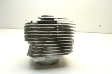

There are these for 2100 - RMC brand out of Italy. I know nothing about them.
If they're the same ones I'm thinking of I had one on a 298. Power wise it seemed on par with a stock 2100 from what I recall. A quick google shows a thread on AS where they posted pics of the internals and they look to be pretty decent quality.
I think @Stump Shot might have experience with the Duke’s 2100 cylinder
