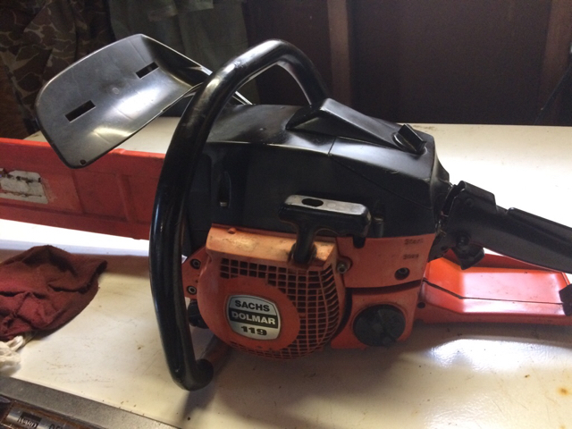

I picked this saw and with a little new gas and a few pulls it runs
Has a broken brake band

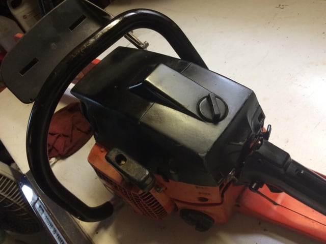

Here she is looks to have done some riding on the clutch cover but pretty clean.
