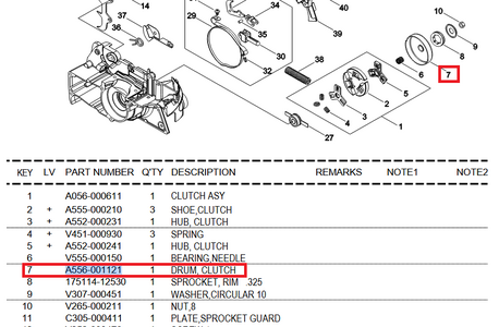

Here is the IPL diagram showing the clutch drum, here it shows using a .325 rim, but you might be able to find a 3/8lp rim to fit it.

452s takes the same clutch drum and standard .325 rim sprocket as our US model echo 490/4910/501p.
The gb 3/8lp sprocket will work.
Clutch drum:
A556001121
