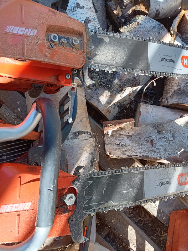

This is where i thought money should go into the 590:
OEM clutch-side felling spikes
Redbeard stihl to echo bar adapter
24" versacut bar/84 dl oregon EXL chain
I am running the Tsumura 20” bar now and Dukes chain. I’ve been very happy with the chain. I also touch it up after any cutting I do so it’s never in too rough of shape.
I wasn’t a fan of the way the outer spike went over the bar nuts. Maybe it’s the steel industry in me but not seeing a thread out the other side of the nut was bugging me.

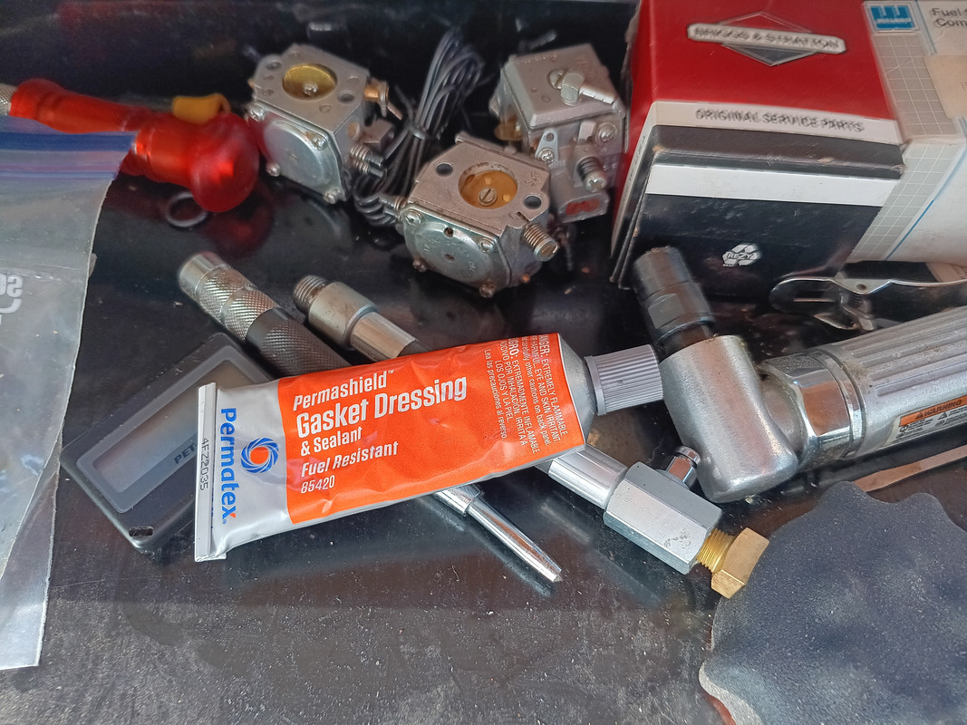

One of my main concerns is how Much Yama or Honda bond. How close to edges do you put it? Both surfaces or one? Let it cure overnight?

Completely cover it with a thin coat. Any extra just squeezes out. Cleaning both surfaces well beforehand is key. Should say on the tube how long to let it cure.

There is nothing wrong with the way the clutch side spikes are attached. It's no different than how many husqvarna pro saws are set up. It's held in place by a torx screw. If anything the steel plate prevents the bar nuts from gouging the magnesium insert and spreads out the bar nut torque.
If just bucking firewood with the 590, no biggey to have a single, but falling trees, you need a set of spikes becuase they're on the small side.
On the base gasket delete, make sure to slightly rough up the base with sand paper, so the sealant has something to hold to. No smooth surface like how its set up for a gasket. Thought I was a weirdo for doing so, but then the saw porter Tree Monkey/Scott Kunz mentions he does the same thing on his base gasket deletes.
If you're afraid of cured sealant getting in the engine, there's always hylomar blue. Permatex even has a better priced version of hylomar right at Napa.
