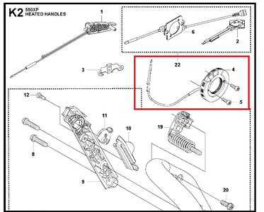

Also does it matter if the heat switch for the handle is on, weaker spark maybe?

I would not believe the heat switch would make a difference to the spark plug, it’s a separate system. I have the same issues with a 550xp, Ms460 arctic, and now Dolmar 7900H when it‘s cold. The Dolmar 6000i will start in 2-3 pulls at -8F however. I wish that saw had heated handles. Warming them up first before heading out is probably the best action.

I wouldn't think the heat being on would affect it either, however, I did run across a 550XPG MKII that had that very same affliction. Turn the heat off and vroooom, away it would go.
Like others have said, I don't think the heat side is stealing any power from the spark. The heated lines are fed by a generator that sits behind the flywheel - totally separate system from the coil/sparkplug. The only thing they share in common is the ground, so if anything it might be the something on the ground side.

Does the heating element just feed strait from the source coil? When switched on.
How many watts is the heat draw with a cold element?
I could imagine that putting juussssst enough drag to be a factor in a cold weather start.
Typically heating elements have a lower resistance when cold i.e. first put under load.
Inrush current is the term I was taught for it.
Think about pull starting your portable generator with a space heater plugged into and switched on. Not quite as easy as it is with everything unplugged, is it?
Would be interesting to see a heated saw back driven with a small electric motor.
Note the speed of motor and check current drawn by the electric motor.
Then switch on the heating element and look at how much current the electric motor draws when the heating element first puts its load on things.
That surge probably lasts about as long as a saw spins when you pull the starter rope, I'd expect.
edit: or think of starting your push mower in the grass (even already cut) vs rolling it over a bare spot and pulling the rope. I bet some of ya have felt that one over the years.
