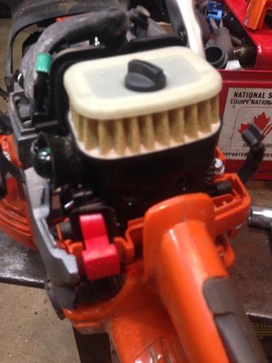

I have the Husky felt filters on my 562s. Who cleans theirs how?
The manual states “ use a brush or shake clean. Use detergent and water to clean fully”
I know some people tap on a hard surface. If I’m in the shop, I usually tap it on all sides, then blow it off with compressed air. I have never washed one with soap and water.
My saw runs noticeably better after cleaning the filter with compressed air than it does just shaking or tapping.

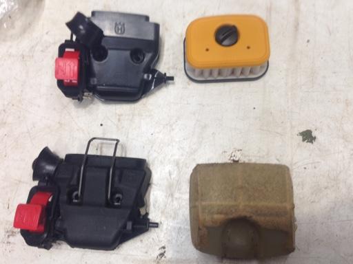

Soap and water for me. Always been nervous about blasting holes in the filter using compressed air. Like larger than designed, but maybe not noticeable. That's just me though.
You definitely don’t want to use compressed air on the older style filters with the wire framework with flocking impregnated in it. It will blow it out. I would wash those particular filters as they are fragile. Newer flocked and mesh filters are more durable.
