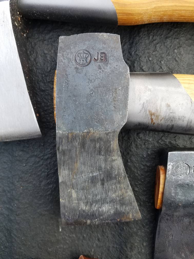

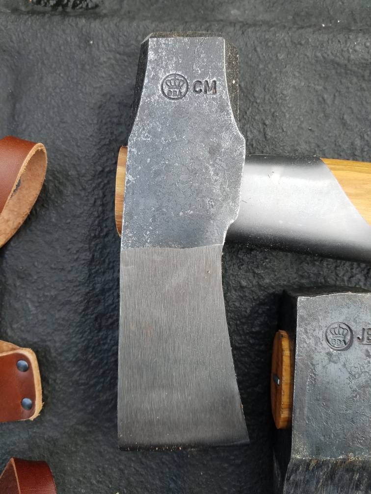

Splitting Ax and splitting maul.

Depends on the size of the rounds. For anything 18" in diameter or less, the large splitting ax works perfect.
For large rounds 2 feet in diameter or larger, the extra weight of the splitting maul really helps. Both are very useful as I split all my wood by hand. Or noodle with a saw. Lol
I know my limitations through experience. [emoji106] [emoji16]

The GB large splitting Ax is really nice. Very fast swing speeds and the head that is forged very hard just explodes the wood.
Here is a short video. Sorry about the end, phone fell over and I did not realize it. Lol
