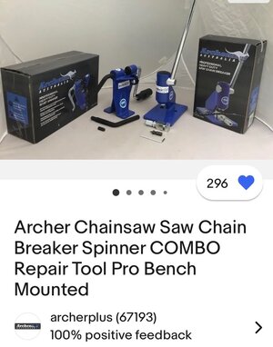

While there are many ‘field expedient’ methods for breaking and joining chain, it really helps to have a good quality spinner and breaker set, for making loops, as wrll as repairs.
I have tried a number of methods, including: a pocket anvil, the Granberg Vise-Grips style, and a few different versions of these small presses.
It is also important to choose a product where spare / replacement parts are available. Punches can break, and small parts can get lost.
This one is compatible with the Tecomec and Oregon products. It also retains a lot of if its value, if you sell it down the line.
A good eBay seller to buy from.

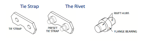

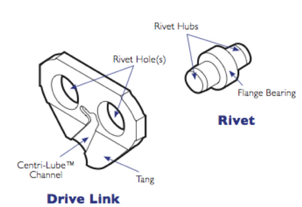

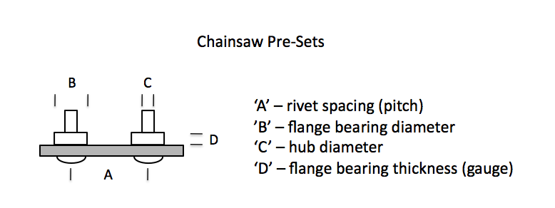

As far as ‘presets’ (master links), your hundred foot roll of chain should have come with some of these.
Oregon OEM presets are available from many on-line dealers, and aftermarket parts are also sold on eBay, Amazon, etc., if you are comfortable with those.
Make sure to match the: pitch, gauge, and type (e.g.narrow kerf chain) because there can be small, but important differences in the links.
STIHL links I buy from my STIHL dealer in bags of 8 or 10.
Consider buying some extras, and practicing on some scrap chain, before doing your good chains. There are also some good YouTube videos on properly using a spinner and breaker.

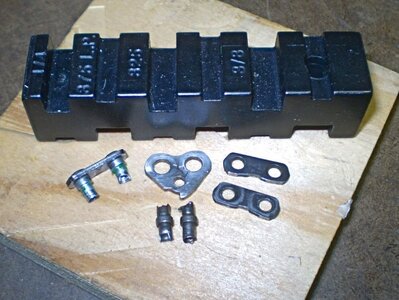

Depending on the block you are punching onto, you will want to make sure the link is squarely in place or else you risk rolling the link and forcing it into the block.
Tacomec makes an anvil that has an appendage to help hold the tie strap better. 111939 (I like it).

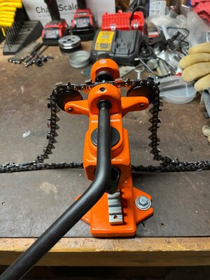

That Stihl NG7 spinner-breaker is nice, Squareground 369, but WOW does it cost some $$$. I won't be breaking much chain, so that's a bit out of my neighborhood! o_O
Squareground3691
2:26 AM
16376
May 1, 2021
3,126
14,922
New England
I got it on a good deal , or I wouldn’t of purchased it, It’s been a real good tool ,

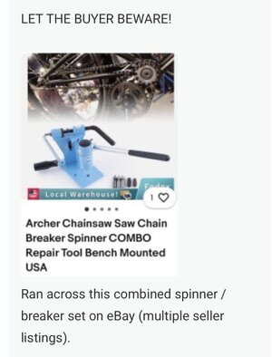

Is the Harbor Freight tool a good tool, Hacskaroly?
I have not used it. The Oregon set I got was from work, they were going to toss them because they replaced it with the Stihl tool. Had I not gotten the set I have, I would have gotten the Harbor Freight tool. I am by no means a pro, this is a hobby for me so I have to be $$ conscious when it comes to getting tools.
hacskaroly
2100 Fanclub Member
11:26 PM
27954
Nov 24, 2023
1,854
6,167
Northern Idaho, Ehh
So which is better - the Tecomec or the Archer? :thinking:
That I don't know, I have not used either. Looking at them both on Archer's site, it looks like the only difference is one is red and the other is blue. They are possibly made by the same company, just marketed different for Tecomec and Archer.

I hear that, but it is a nice rig! Harbor Freight has/had a similar set up for about $60 if I remember correctly.
Avoid HF. Poor quality, and no parts available, as I understand it.
(Tecomec, Oregon, Archer, and a couple of others through the years, come out of the same factory.
Shhhh! It’s a secret!!
Used to be Italy, but now it’s China)
