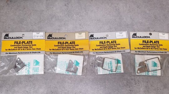

I do not have any of the original Carlton 37509 available, but I do have a few of the others. The blue one is as close to 37509 and I could make it to the original Carlton. The bottom 2 are McCulloch branded, I don't know what kind of arrangements they made with Carlton at the time.

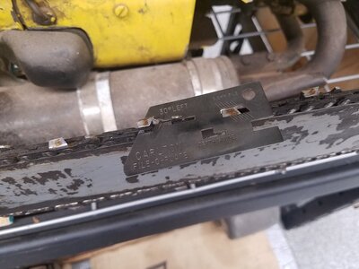

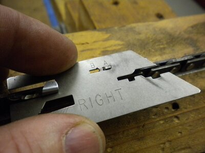

The File-O-Plates tend to be very chain specific, one that fits properly on Carlton 3/8" chisel chain will probably not fit 3/8" semi-chisel chain and may not fit another manufacturer 3/8" chisel chain, just be aware.
In this photo the plate it correctly oriented for filing the LH cutter, the angle on the plate provides a visual guide and the plate fits below the file to keep the file at the correct height in the cutter. The temptation is to press the file hard against the plate to keep it low enough, but doing that repeatedly just dulls the file that much more quickly. The scale in the front promotes keeping all of the cutters the same length. If you use the depth gauge orientation this is not so critical since this is a "progressive" gauge and adjusts the height of the depth gauge based on the cutter height.

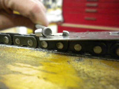

Here you can see how the front of the File-O-Plate rests on the depth gauge of the cutter ahead of the cutter you are filing. If I remember the Carlton instructions correctly, they recommended filing the depth gauges first, then the cutters but I always did it in the opposite sequence (cutters first, depth gauges last) and had very good results.

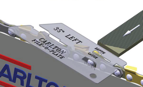

This photo shows how the plate works to keep the file at the correct height/depth in the cutter tooth.
Here you can see the File-O-Plate moved into position for filing the depth gauge. The "A" and "B" slots are sometimes designated "hard" and "soft" with less clearance provided in the "A" position and more in the "B" position. I never tried to measure the actual relief of the depth gauges, and it would change as the tooth is filed back in any case. In general, the depth gauge will be 0.020" to 0.030" below the cutter height for best performance. Less clearance will be smoother but slower cutting, more clearance can make the chain too grabby for casual users or low power saws.

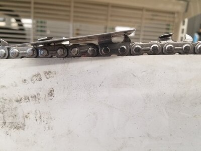

There are some other variations of the File-O-Plates for use with chains equipped with bumper or guard links, often referred to as low-vibration or safety chain.
If I can't find a photo of one in position I will see about getting some photos, or at least a copy of the instructions showing the File-O-Plate in position on those types of chains.

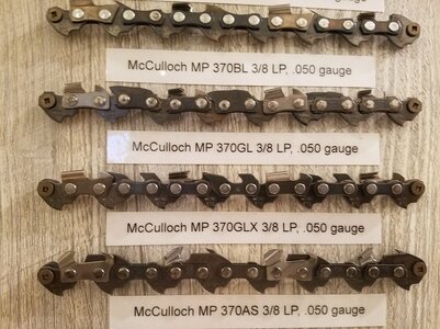

FWIW here is the McCulloch page demonstrating the use of the File-O-Plate on GLX type chain.
The third chain down is MP370 GLX, 3/8 LP chain with the GLX aka Shark Fin type guard links.
