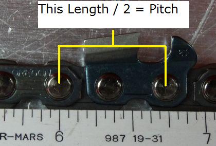

Acre's site ( @OldJack post above) can be a good resource. 1/2" pitch was common on Homelite Zip saws. This chain gauge lists some of the other sizes that were available at some point:
It might be possible to also find a .404 sprocket for that saw (?) if it is something that you want to cut with.
