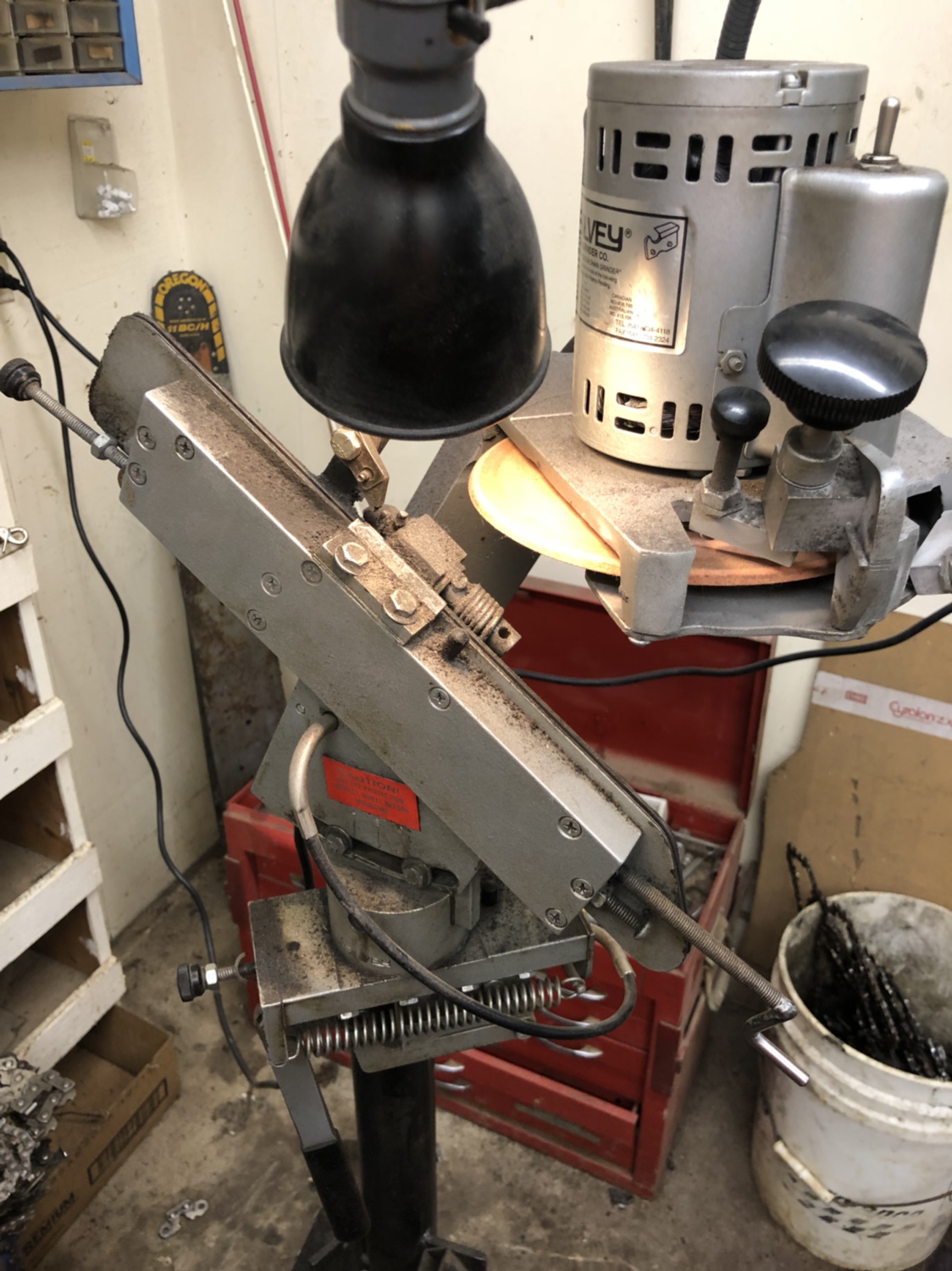

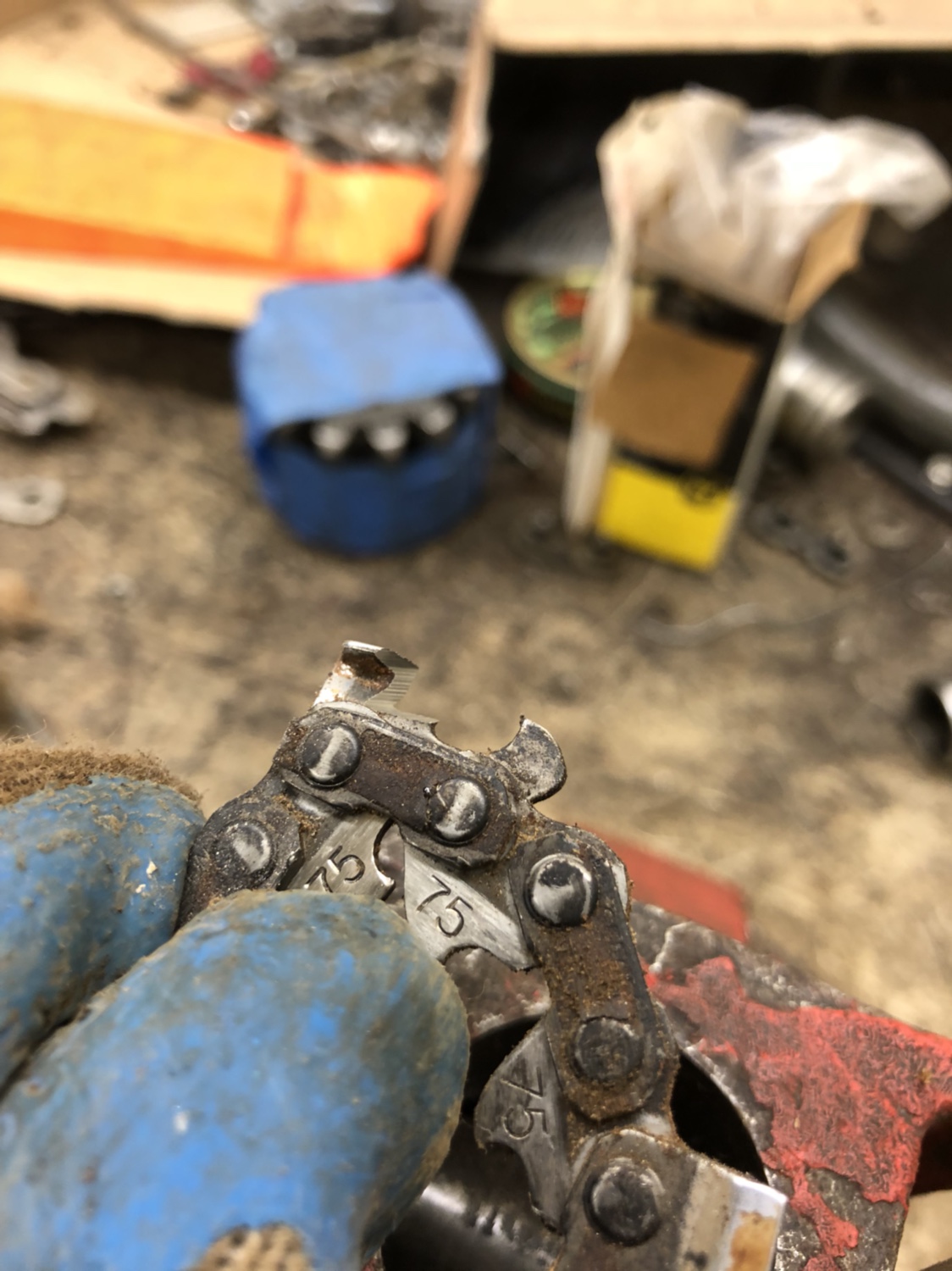

This works good:
Pic before the Nielsen 100B was added for rakers:
Experimental prototype converting cheap Tecomec to Silvey 510 style, (geometry isn't quite right)
