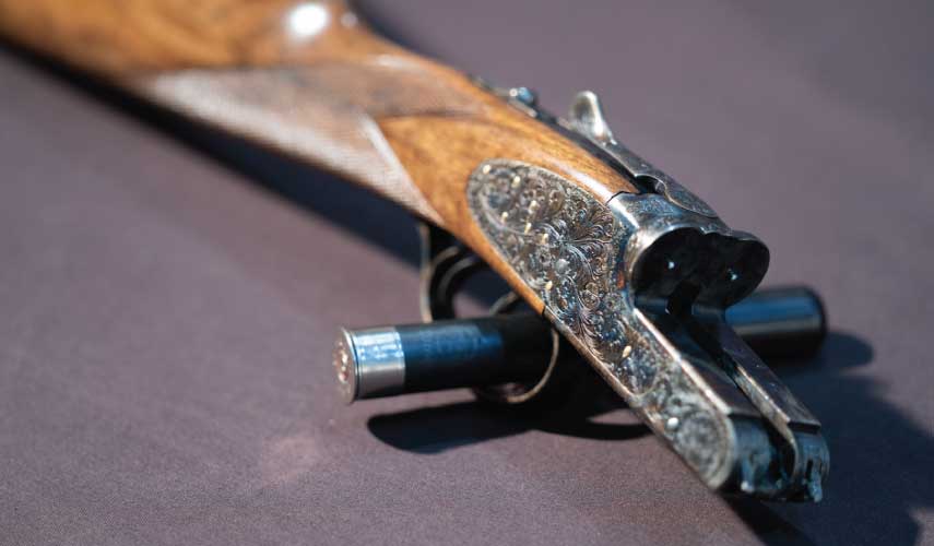

The coloring is certainly attractive, and now is done mainly as decoration, but casehardening was originally used to harden the outer layer of ferrous metal by driving more carbon into it under high heat while leaving a softer inner core, desirable for "toughness" in tools, guns, etc. made back before tool steels and such were developed. The item is packed in a container with charcoal and bone (in the case of firearms), the whole thing is heated to something like 1300 degrees, then quickly quenched, usually in oil. True color-casehardening is a pretty involved process. Here's a couple of links if you care to know more. Turnbull is considered an artist for his color case-hardening and gun restoration skills:
As @heimannm pointed out, gun bluing or browning is a completely different process, whose purpose is to provide a protective layer on the steel. A good bluing job is certainly attractive, but the appearance was not the primary purpose originally.

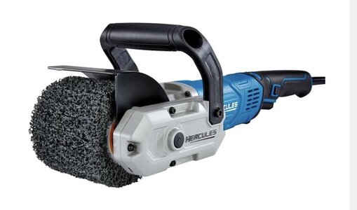

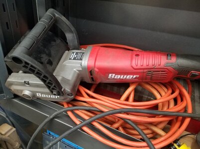

Surface preparation tool from Harbor Freight.
Thanks.
I’m not promoting or disparaging HF: I just recall that from an earlier post (somewhere), and it seemed to fit the discussion.
Here are a few more images:
Note that other companies also make these kinds of tools, and there appear to be a range of abrasive wheels, including wire, ScotchBrite type, flaps, etc.
Looks like a good tool if there are a lot of bars to do. I suggested a belt sander as another option.
If someone just wants to ‘cleanup’ a bar, and was flexible about the resulting ‘scratch pattern’, a random orbital sander would work too.

I believe that HF has moved from the Bauer line to the Hercules, the last drum(s) I picked up were Hercules and they seem to work O.K.

I think you are baiting me Thomas...I've only used it on chainsaw bars...videos show guys stripping auto body panels. I guess you are supposed to call it a surface conditioning tool...
