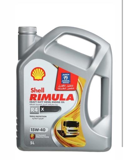

You mean truck oil alone or with STP treatment too ?
wesamswailem
4:18 PM
16551
May 20, 2021
36
64
Egypt
This !?

This !?
Yup
Heavy zinc will friction weld to your bar if overheated.
You can add on in hot weather. We get temps to 100F and the sunny days with humidity are brutal.
Mid 90's all this week. Good time to use an anti-sling additive.
